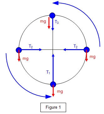

Suppose we have a vertical circular motion with gravity according to the image below.
In the leftmost and rightmost positions the resultant force is pointing diagonally down. Isn't the resultant force supposed to be pointing at the center at all times in a circular motion? What am I getting wrong?

There's a difference between circular motion in this case and uniform circular motion (i.e. at constant speed).

Ok, so let me get this straight. The resultant force in a circular motion is always pointing to the center if, and only if, the motion is at a constant speed. For example, if we are spinning a weight attached in a string vertically in a gravity field it will NOT have constant speed and therefore the rule does not apply.
Is this correct?

Yes. In general (this applies to any motion, in fact), the component of the force perpendicular to the instantaneous direction of motion changes only the direction (not the speed) and the component parallel to the direction of motion changes the speed.

Yes, see also:
https://en.wikipedia.org/wiki/Acceleration#Tangential_and_centripetal_acceleration
