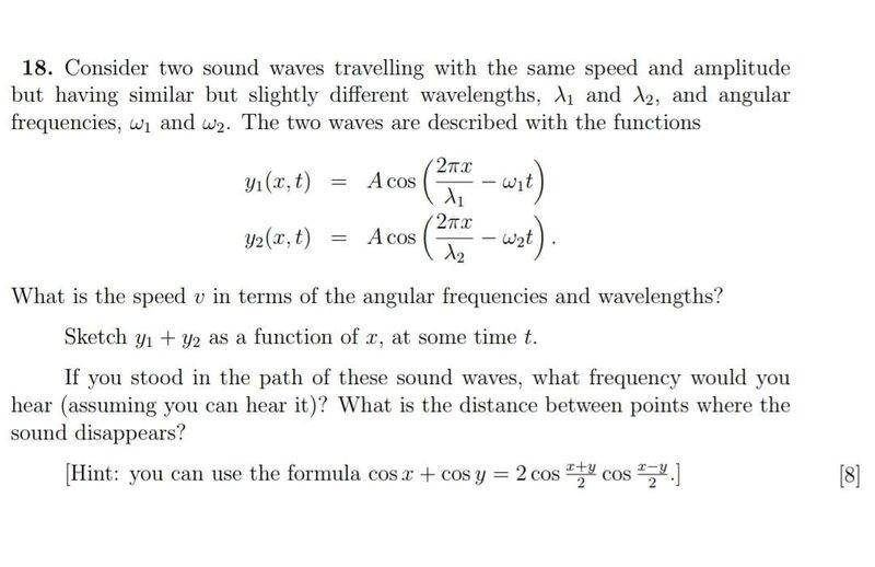

What is the speed ##v## in terms of the angular frequencies and wavelengths?
Sketch ##y1+y2## as a function of ##x##, at some time ##t##.
If you stood in a path of these sound waves, what frequency would you hear? What is the distance between points where the sound disappears?
$$v=f\lambda$$
$$y(x,t)=Acos(\frac{2\pi x}{\lambda}-\omega t)$$

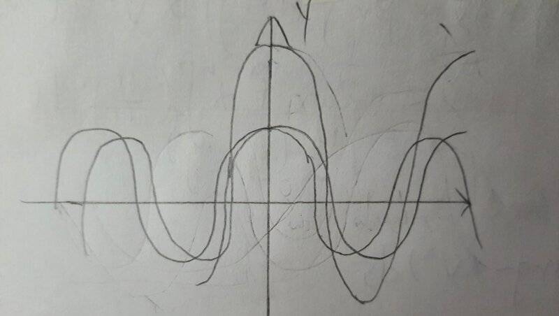

##-w1## and ##-w2## are to shift the cosine graph to the right, and ##\frac{2pi}{\lambda}## is to stretch the graph. But I can't seem to draw an appropriate ##y1+y2## graph (quite irregular) and I struggle to find the resultant frequency and wavelength. Also, why is there angular frequency in a sound wave?

Like I said I got an irregular graph for y1+y2 (by plotting y1 and y2 and visually adding them together, since it is quite impossible to plot a graph using the formula derived with the hint)

##\omega=2\pi f## and ##v=f\lambda##, so ##v_1=\frac{\omega_1\lambda_1}{2\pi}## and ##v_2=\frac{\omega_2\lambda_2}{2\pi}##.
$$y_1(x,t)+y_2(x,t)=A(\cos(\frac{2\pi x}{\lambda_1}-\omega_1t)+\cos(\frac{2\pi x}{\lambda_2}-\omega_2t))$$
$$=A\cos(\frac{1}{2}(\frac{2\pi x}{\lambda_1}-\omega_1t+\frac{2\pi x}{\lambda_2}-\omega_2t))\cos(\frac{1}{2}(\frac{2\pi x}{\lambda_1}-\omega_1t-\frac{2\pi x}{\lambda_2}+\omega_2t))$$
$$=A\cos(\pi x(\frac{1}{\lambda_1}+\frac{1}{\lambda_2})-\frac{\omega_1+\omega_2}{2}t)\cos(\pi x(\frac{1}{\lambda_1}-\frac{1}{\lambda_2})-\frac{\omega_1t-\omega_2}{2}t)$$
Applying the hint gives a product of cosines which I struggle to plot a graph for it. That was why I went for plotting ##y_1## and ##y_2## separately then add them visually, but I couldn't plot a significant graph. Also, I don't want to use Desmos.
Well done. Especially for using Latex so well.
Don’t forget the leading factor ‘2’ in the identity:
##cos(x) + cos(y) = 2cos(\frac {x+y}{2})cos(\frac {x-y}{2})##
And you have written ##\omega_1 t## instead of just ##\omega _1## near the end of the last equation.
We can tidy up your last equation by defining some new variables.
##k_A= \pi (\frac {1}{λ_1} +\frac {1}{λ_2})##
##k_B = \pi (\frac{1}{λ_1} -\frac {1}{λ_2})##
##ω_A = \frac {ω_1 + ω_2}{2}##
##ω_B = \frac {ω_1 – ω_2}{2}##
We end up with
##y_1(x,t)+y_2(x,t)= 2A\cos(k_A x - \omega_A t) \cos(k_B x - \omega_B t)##
We are asked to sketch the graph for ##y_1 +y_2## as a function of x at some time t. Since we are not told the value of t, we are justified in taking t=0. (A different, non-zero, value of t will give the same shape graph but shifted left/right.)
So we need to sketch the graph ##y = 2A\cos(k_Ax) \cos(k_B x) ##
We are told ## λ_1## and ##λ_2## are similar, so k_B is large compared to k_A. (I think it’s that way around!)
To get the general shape we could plot a graph of (for instance) ##y = cos(x)cos(10x)##.
Although it’s now manageable, plotting this by hand is still pretty hard work. I wouldn’t want to do it. Can’t a graphical calculator be used?
If your maths is good (and especially if you are familiar with the maths of ‘beats’) then you might recognise that you have a short wavelength sine-wave amplitude-modulated by a much longer wavelength sine-wave. Then it’s easy to sketch the general shape of the graph.
