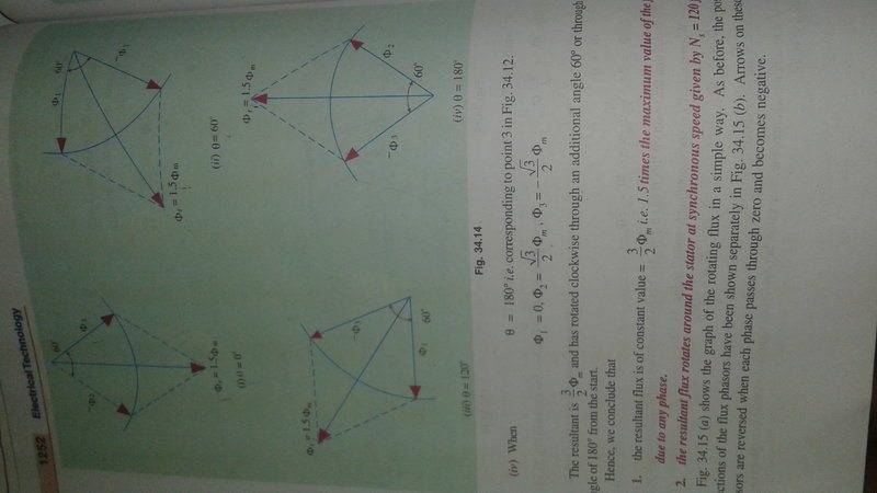

I have some attachements below from my textbook. According to it the value of resultant flux is constant in magnitude and 1.5 times the maximum value of flux.
But i have a doubt regarding how it is proved.
The magnetic flux waveforms are 120° apart from each other and at time 0, the instantaneous value of flux waveform of 1st phase is zero. Whereas 2nd phase has magnitude -√3/2.Φm and the third phase √3/2.Φm.The textbook says that:
Φr = 2.(√3/2)Φm.cos60/2
Here is my doubt
If the fluxes are 120° apart, shouldn't the equation be: Φr = 2.(√3/2)Φm.cos120/2 ?
Please explain me in the simple way how this works.i appreciate the help:) [/B]

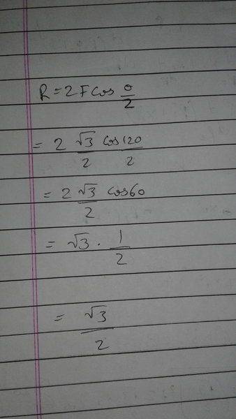

This is what I am getting as answer

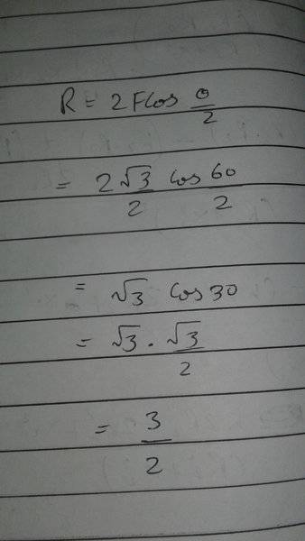

But the same one when i solve using cos60/2 :
The formula you used in #7 works for two 'equal' vectors. The fluxes here are √3/2 and
-√3/2, which are not equal. You can rotate the second vector by 180° and its magnitude will be √3/2. Now the angle between the two phasors is 60° and the formula works as it did in #8.

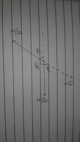

Oh i got it! Here is one more attachment. This is how i need to think about it?

That's right.

Thanks so much i really got this concept clear today. I realized that what i didn't know is that vectors can't have negative magnitude now if i keep this in mind my concept about resultant flux is clearly understood. :)

Does the magnitude of resultant flux not get affected when we move -√3/2 by 180°.
Is it okay to do so ?
rishi kesh said:
Hi !
Sorry, but one more question is overwhelming me right now.
Yes.
Rotating a vector by 180° and changing its sign gives the same vector. It is like multplying a number by -1 twice.
cnh1995 said:
Yes.
Okay. So what does negative sign mean ? Does it mean opposite direction? Like if right side is positive then left is negative?
Kind of like that, yes.
