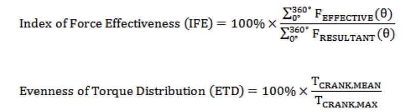

You have been given pedalling force data for 10 cyclists to analyse. Write a Matlab code to calculate the following for each cyclist:
Throughout the pedal stroke (i.e. additional columns of data):
• Resultant pedal force (FRESULTANT)
• Force tangential to the crank arm (crank arm length = 170 mm) (i.e. the effective pedal force, FEFFECTIVE)
Single values for the pedal stroke:
• Peak torque and angle of peak torque
• Positive and negative work done during the pedal stroke
• Mean power throughout the pedal stroke
• Index of Force effectiveness (IFE)
• Evenness of torque distribution (ETD)
Part 2
Divide the cyclists into two groups based on their ETD values; a good group with ETD ≥ 25%; and a poor group with ETD < 25%. Perform statistical tests to determine if there is a difference between these two groups for each of the remaining six single value variables calculated above. Present the results for each of these six variables as bar charts (presenting the mean and standard deviation for each group)

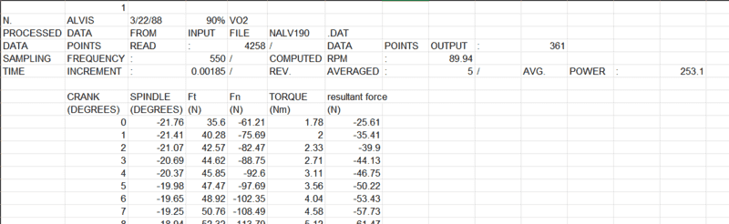

The cyclist data is in an excel spreadsheet that can be downloaded from Learn (data_cycle_10.xlsx). Each worksheet contains the data for one cyclist and the five columns to data are:
CRANK crank angle measured clockwise from top dead centre (i.e. vertical pointing upwards)
SPINDLE pedal spindle angle measured anti-clockwise from horizontal
Ft and Fn are the forces applied to the pedals tangential and normal to the pedal surface
TORQUE torque applied to turning the crank arm (TCRANK)
attached below as photos

You didn't post a diagram of the system, as I asked. Show the crank and pedal, marking the angles and applied forces.
Two things I do not understand in the problem statement:
- it is not clear which way is positive for Ft
- telling you the torque should be unnecessary since you can compute it from the other data… except that it does at least tell you which way Ft is measured.
I am unfamiliar with the language you write the code in. Please explain in algebra how you are calculating the answers.
