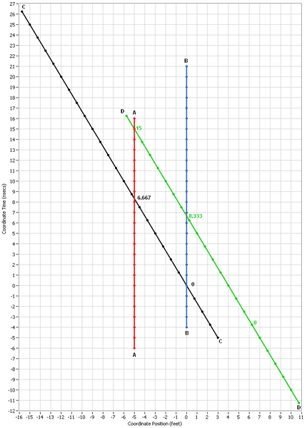

I will answer your questions for a specific example where L = 5 feet and v = 0.6c and where c = 1 foot per nsec. First, a spacetime diagram in which A and B are at rest:
I think you can see that this meets all your specifications.

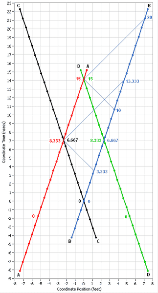

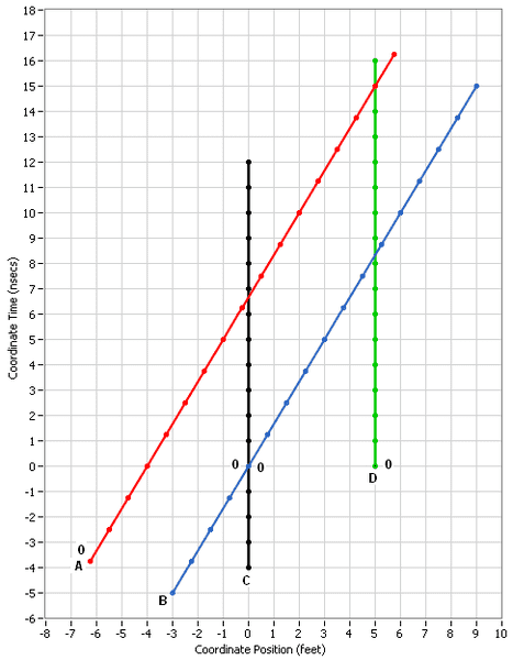

Now a spacetime diagram in which C and D are at rest:
This second diagram was not drawn from scratch, rather it was created simply by using the Lorentz Transformation process to convert the coordinates of significant events in the first diagram into one moving at -0.6c with respect to the first one. Since the worldlines in this diagram are mirror images of the ones from the first diagram and since the LT was used to create this diagram, this indicates that the first one was correctly drawn in terms of the placement of C and D.
Now we're ready to answer your questions. If you count the number of dots representing clock ticks for each clock, you can see that the time on A and D at their conjunction with B or C is 8.333 nsec and the time on B and C at the same conjunction is 6.667 nsec. From this you should be able to determine formulas as a function of v and L.

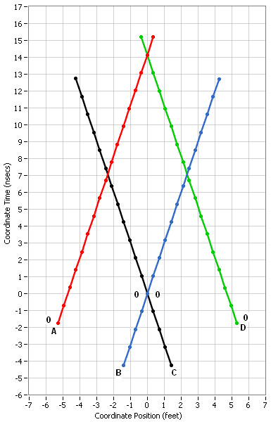

And finally, just for the fun of it, here is another spacetime diagram in which all observers are traveling at the same speed:
This spacetime diagram was created by transforming the first diagram into one moving at -0.333c with respect to it.
Note that in all three of these spacetime diagrams, the same answers to your questions can be determined. Also note that we needed the first one (or something equivalent) in order to establish the clock synchronization for clocks A and B and we needed the second one to establish clock synchronization for clocks C and D.

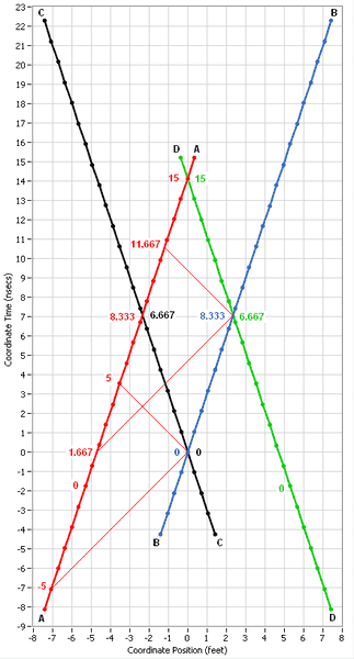

The observers don't actually see or observe the other rod to be shorter than their own nor do they observe Time Dilation, they establish these features using radar methods by making an assumption about the propagation of light and then by making some measurements and doing some calculations. Let me show you by going back to the third diagram on my previous post except that I have extended some of the worldlines:
In this drawing, we will focus on the red observer A and how he uses radar to establish his own rest frame. Although he would typically be sending out radar signals continually, I only show the two most important of them. The first one he sends out at his Proper Time of -5 nsecs. It travels upwards to the right along a 45 degree diagonal and bounces off both B and C at their Proper Time of 0 nsecs. The reflection arrives back at A at his proper time of 5 nsecs and so the radar signal was gone for 10 nsec. Now here's where he makes his assumption. He assumes that the radar signal took the same amount of time to get to B and C as it did to get back. From this, he concludes that B and C were 5 light-nsecs away at the midpoint of his measurement (half way between sending and receiving the radar signal) so that means that when his Proper Time was 0 nsecs, B and C were 5 light-nsecs or 5 feet away.
Now he watches C traveling towards him and observes that he gets to him at his Proper Time of 8.333 nsecs. From this he concludes that C is traveling at 5 feet per 8.333 nsecs or 0.6 feet per nsec.
He continues to watch the rod and at his Proper Time of 15 nsecs, the other end at D passes him. Since it took 15-8.333 = 6.667 nsecs for this to happen and since the rod is traveling at 0.6c, he calculates that its length is velocity multiplied by time or 0.6*6.667 = 4 light nsecs or 4 feet. Since he measured his own rod to be 5 feet, this is in accord with the Lorentz contraction of 0.8 at 0.6c.
Now what about Time Dilation? He bases this on the fact that his measurement established that C's clock read 0 nsecs at the same time his read 0 nsecs and then 8.333 nsecs later according to his clock, C's clock read 6.667. This is a ratio of 1.25, the Time Dilation factor at 0.6c.
Meanwhile, he has sent out another radar signal at his Proper Time of 1.667 nsecs. It hits B and D and then returns at his Proper Time of 11.667. Like before, the radar signal was gone for 10 nsecs so he once again declares that B and C were 5 feet away at his Proper Time of 6.667 nsecs. He can also see that when he receives the radar signal, B's clock read 6.667 nsecs and D's clock read 8.333 nsecs.
He can put all this information together and eventually create a diagram of his rest frame based on his measurements and assumptions about the propagation of light. It looks like this:
Note that I have included Proper Time labels only for the moving observers since A and B are not moving, their Proper Times are always the same as the Coordinate Times so all you have to do is look over at the scale on the left-hand side to see any Proper Time for A or B.

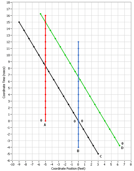

Now we can repeat the whole process to show how B can use radar measurements and here's another diagram to show that:
I'll leave it to you to verify the details.
Finally, we could repeat the whole process showing the radar measurements for C and D. I think you can see that all the numbers would be the same, just the labels would be different and it would be a kind of mirror image. Can you see how it is possible for each observer to establish their own frame of reference based on their own assumption that light propagates at c with respect to themself and that this leads to them both determining that the other ones moving rod is Length Contracted and the other ones moving clocks are Time Dilated?
