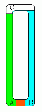

The original problem was as follows:
Closed-loop system, with complete isolation.
Salt water is green, fresh water blue,
porous plug (AB) is red.
Fresh water spills into the salt water column
at C if the fresh water is lifted
higher than the salt water,
maintaining continuous flow.
Can this really happen?
The theory that i worked out is that the pressure in the bottom of any of the columns is Pressure = density x constant of gravity x height
The density of pure water is 1000 kg/m^3, while the density of salt water is 1025 kg/m^3. This means that the pressure at the bottom of a salt water column is 2.5% higher than the fresh water.
The osmotic pressure needed to drive water from the salty side to the fresh side is 1450kPa, or around 14.5 bar.
If both columns are around 6km high, the osmotic pressure at the bottom of:
the salt water tank is 1025 * 9.8 * 6000 = 60.27 MPa, or 602.7 bar
the fresh water tank is 1000 * 9.8 * 6000 = 58.8 MPa, or 588 bar
The difference in pressure is 14.7 bar, enough to counter the 14.5bar requirement for reverse osmosis. The salt column's pressure now pumps fresh water into the fresh water column.
If the freshwater feeds back into the saltwater column, after perhaps passing a waterwheel that generates power, this becomes a perpetual motion machine.
some considerations noted: the saltwater will not become diluted by the fresh water pouring over at the top since the salt never leaves the column through the semi-permeable membrane
I know it doesn't really work due to thermodynamics, but i can't figure out why in terms of fluid dynamics and statics. Please tell me why it doesn't work, i can't figure it out.

Well, the idea is that the increased density of the salt-water will perform reverse osmosis. Have a look at the numbers.
This problem appears to have stumped the author of the site you got that pic from. I suspect the answer has something to do with the energy associated with the chemical process of osmosis, which unfortunately, I don't fully understand. Perhaps a chemist can verify this, but a temperature change across the membrane either due to the chemical process or the thermodynamics of flow through a nozzle could provide the answer.
This hints at it, but unfortunately, I can only get the abstract:
The van't Hoff formula for osmotic pressure, which is identical in form to the formula for ideal gas pressure, is a direct outcome of the second law of thermodynamics. The formula is derived by applying a closed cycle reversible and isothermal process, following an argument in Fermi's book on thermodynamics.
http://scitation.aip.org/getabs/servlet/GetabsServlet?prog=normal&id=AJPIAS000075000011000997000001&idtype=cvips&gifs=yes
This implies to me that if you don't return that potential energy to the salt water (ie, you extract it with a turbine), the entire system will cool continuously until the water freezes.
Where are you getting your numbers (for the osmotic pressure between water at high compression and brine at high compression)?
His numbers are fine.

Well, according to http://en.wikipedia.org/wiki/Osmotic_pressure, the osmotic pressure should simply be linear to the molarity (and temperature, but that is constant anyway). I looked up the water potential pressures in a table that i cannot find for the moment, but here is a diffrent example: http://books.google.se/books?id=oAF...5uWhCw&sa=X&oi=book_result&ct=result&resnum=2. This is for sucrose, but all that it might be different from salt is in its van't Hoff factor, but since we are considering salt-water with pure water, neither this plays a role.
Simply put, the molarity is the only thing that plays a role, and it serves to put a relatively lower osmotic pressure on the side with higher molarity.

If osmotic pressure is independent of absolute pressure, then I would guess conway is right: that the energy extracted will be insufficient to mix the saline gradient.

Yes it seems to be that osmotic pressure is independent of absolute pressure, it was one of my first ideas to try to uncover the answer, but to no avail. You mean that the pressure exerted will not be enough to work backwards against the saline gradient, or did i misunderstand you?
Anyway it seems that, given that the osmotic pressure is independent, the pressure difference at those depths generated by difference in densities should be enough to make the process run in the correct (impossible) direction.

The 1st law of thermodynamics, the law of conservation of energy is what you describe. There is the second law, the law I am referring to, that makes this freezing over, charged battery, argument impossible. As you might know, this law deals with work, not just energy. You are correct in assuming that the 1st cycle of the freezing-over of the system might represent energy stored in the initialization, but if we assume that the waste heat of whatever appliance we used the useful work from the turbine for, returns back to heat both water columns again, then we still get useful work without freezing the columns.
Hence, the system still represents free energy (or rather work), which is of course impossible.
Still, my main aim here is not to state that this will work or that it will not work, what I am looking for is the missing osmosis / fluid-static theory that will make the math converge with thermodynamics.

The chemical potential of the salt will be constant as a function of the height. The gravitational potential contributes to the chemical potential, and this then leads to a formula for the concentration of the salt as a function of the height, analogous to the formula that gives you the pressure as a function of the height in the atmosphere. This means that the concentration of the salt at the bottom is much higher than at the top. So, the osmotic pressure is higher too.
  • #35
Another way to see this is to simply consider hydrostatic equilibrium. The water will only flow through the membrane if the partial pressure of the water becomes higher on the left side than on the right side if we add the salt there. But this is exactly what does not happen. The total pressure increases due to the weight of the salt, but this is accounted for by the partial presssure of the salt ions.
