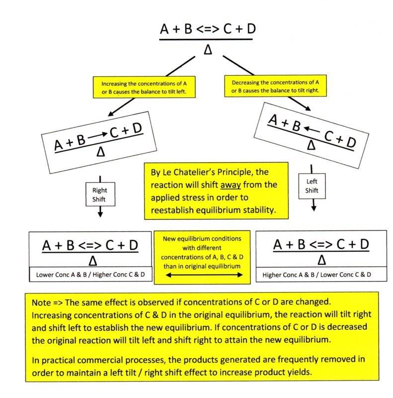

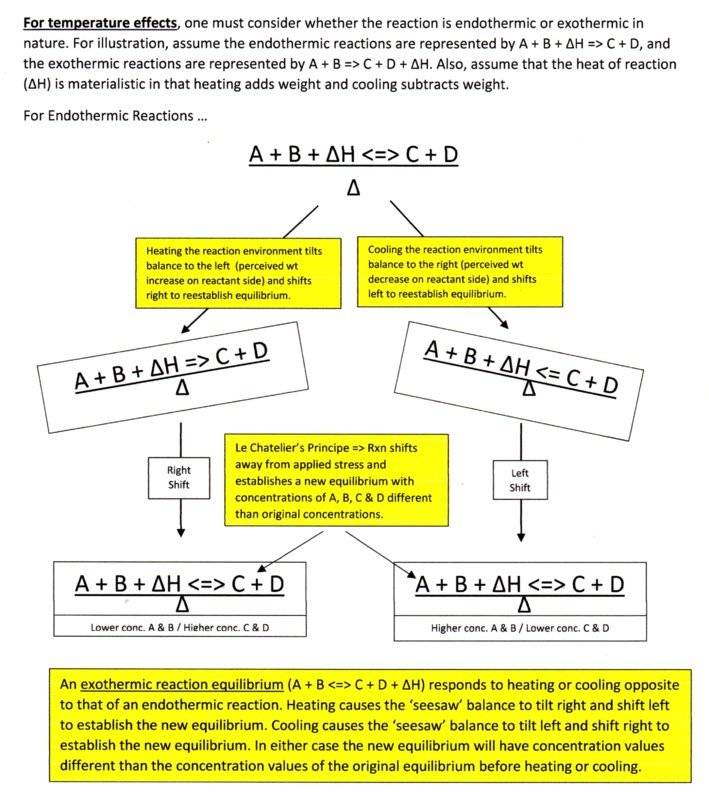

Generally, equilibrium stability is affected by one, two or a combination of three factors. These are concentration effects, temperature affects & pressure-volume effects. One way that is used to visualize the effect of concentration and/or temperature effects is the 'seesaw analysis'. Pressure-Volume effect follows after concentration & temperature effects.
Consider the following hypothetical reaction (A + B <=> C + D) and assume while at equilibrium it is balanced on a seesaw...
Concentration Effects can be perceived as follows ...
