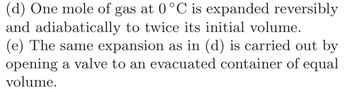

Calculate the change in entropy of the universe
##\Delta S = \int_i^f{\frac{dQ}{T}}##
Answer for (d) is 0, answer for (e) is not.
Firstly, I don't get why (e) is not zero. It says "the same expansion" so that expansion is reversible. Reversible processes -> entropy = 0?
Secondly, part (e) seems to be the exact same as (d) so I'm not sure why it's different!
Thanks in advance

(d) is reversible, (e) is not. (e) is actually a free expansion.
In (d) the system's temperature changes, whereas in (e) it doesn't. That's another difference between them.
Likes Lord Jestocost
Ah okay, but the phrasing "same expansion" seems to suggest (e) is reversible, the same as (d), no?
They should have written "expansion with the same initial and final volume".
(e) is clearly a free expansion so it can't be exactly the same as (d).
In (e) no work is done by the the gas, in (d) there is.

The problem with the question as provided is that it does not state that it is an ideal gas.
If it is an ideal gas, there will be no temperature change as ##\Delta U=nC_v\Delta T=0##. So the change of entropy is the change of entropy over a reversible adiabatic expansion to twice the volume (##\Delta S=0##, ##T=T_a##) plus the change in entropy of a reversible heat flow into the gas at constant volume to bring the temperature up to the original 0C/273K. ##\Delta S_{gas}=\int_{T_a}^{273}\frac{nC_vdT}{T}=nC_v\ln\left(\frac{273}{T_a}\right)##. One just has to determine the temperature after the adiabatic expansion ##T_a## (using the adiabatic condition and ##\gamma## of the gas). Alternatively, you could use a reversible expansion at constant temperature (constant U) and equate W and Q so ##\Delta S_{gas}=\int_{V_i}^{V_f}\frac{PdV}{T}=\int_{V_i}^{V_f}\frac{nRTdV}{TV}=nR\int_{V_i}^{V_f}\frac{dV}{V}=nR\ln\left(\frac{Vf}{V_i}\right)=nR\ln(2)##. Change in entropy of the surroundings is ##\Delta S=-\Delta Q_{gas}/273##
But if it is a real gas in which there are inter-molecular forces, potential energy of the molecules will increase with free expansion and temperature of the expanded gas will decrease despite the lack of work being done by the gas. So the reversible path for determining change in entropy will depend on its final temperature and heat capacity.

The reversible path is whatever we specify iii to be. Some reversible paths only involve the heat capacity in the ideal gas limit (which we know) as a function of temperature.
