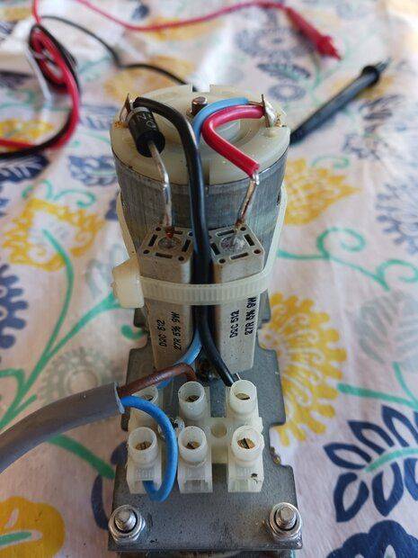

What are these components on my reversible motor and how is the whole thing supposed to work?
I have a reversible electric motor that operates an automatic skylight, vintage 1985. I'm trying to figure out how it is supposed to work, but I don't recognize the rectangular gray components that are secured to the motor case with a length of plastic zip-tie. What might they be and how would the whole thing work?
They are 27 ohm power resistors, probably to limit maximum motor current = torque.
They look like fusible cement resistors, ##27~\Omega,\ 9~\mathrm{W}## with ##5\%## tolerance.
Probably just a typo, but I believe you are referring to Cermet.
That is a compound of cer[/size]amic and met[/size]al, which combine to give characteristics of both.

Tom.G said:
Probably just a typo, ...
Maybe not.
I think you will find the higher power, low value resistors like those are wire wound on the inside, with a ceramic or cement case to reduce wire oxidation and fire hazard.
Cermet resistors are usually more expensive, with power 1 watt or less, higher resistance, and lower inductance.
Destructive testing would resolve the question.
The series diode is interesting. Does it provide directional control of the torque limit?
