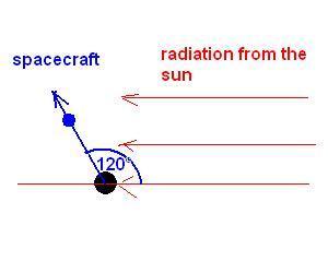

The "Solar Sail I" experimental spacecraft is launched from the international space station with an initial velocity of 12 m/sec in a direction that makes a 120 angle with respect to the direction of radiation coming from the sun. Measurements show that an acceleration of 0.5 m/sec is imparted to the spacecraft by the pressure of sunlight pushing against its soar sail. Calculate the time taken for the spacecraft speed to increase 100 m/sec.

Read the problem text again and make a figure.
If I set the direction of the spacecraft along the x-axis in the west direction, would that mean the angle is 30 degrees north of west which would result in a 120 degree angle for the sun?
It looks OK.

I think that the velocity of the spacecraft is given with respect to the Space Station which is considered an inertia system. You have a specific direction: that of the Sun. The Sun is very far away so its rays can be considered parallel, as shown in the attachment. The motion of the spacecraft is like that of a projectile. I hope the problem was meant in this way but I may be wrong.
ehild
That's the way I was picturing it.

Do not worry about relative velocity. You are given the initial velocity and the acceleration. The initial velocity has both horizontal and vertical (or westward and northward) components the acceleration is horizontal (westward)ehild
So which angle would I use for the formulas?
60 degrees ? or the entire 120 degrees?
Do according to the picture. As you need the magnitude of the components, use 60 degree.
