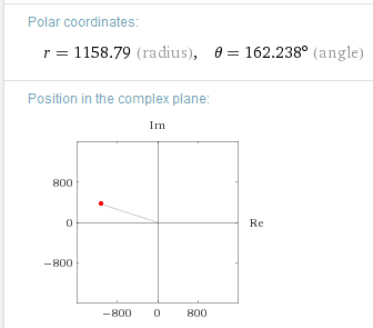

$-1103.55+j353.5$
In polar coordinates:
$1158.79 \angle 162.2$, but the book gets $1158.79\angle 107.76$
The book answer is wrong?
(I normally use the quadrant argument, but when I get rational functions in rectangular form and stick it into a calculator, I can't really distill which quadrant it belongs to, so I decide to stick with adding 180 degrees. I could rationalize it the denominator, but there isn't enough time on the exam :D)
Just busting your chops, my friend...I have days where nothing I post is right the first time...:D
W|A agrees with you:
You basically need atan2 - Wikipedia, the free encyclopedia (scroll down to "definition and computation" to see how it is defined, watch out for the order of the arguments). This will make sure to return the right angle in every case, assuming that zero radians is along the positive real axis and you measure counterclockwise.
