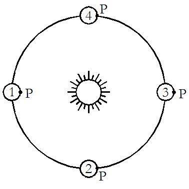

A few days back, I had an argument with a person on a social media platform regarding the effect of the absence of diurnal motion (rotation of Earth on its own axis). According to him, there would be a change in "Day-Night" even if only the Earth's revolution around the Sun is present. In support, he also showed a diagram which I am enclosing with this post. I disagreed, arguing that it is not possible that a point on the periphery of Earth will change its position relative to the Sun if there is no rotation of Earth. He then argued that if any other external star system/star is taken as a reference frame then it is possible.
I would like to request you all to help me out in the following two points:
1. Is he right? Am I making any mistake in understanding? Is the diagram attached right or wrong?
2. I am unable to formulate a pointed and logical reply in an organized manner to counter his argument. Provided he is wrong, I would like to request you to help me on this.
Under the influence of a central force and in absence of any torque, how can the position of a point on the periphery of the object change with respect to the central point or any other reference frame?
I hope I have clarified my dilemma and question clearly to the members. If you require any other input, please feel free to ask. I am unable to post the conversation, as it was in my mother tongue "Bengali" and I am sure most of the members here would have no use for that.
Thank you all, waiting eagerly for your reply.

src2206 said:
1. Is he right?
yes
you have to be since you're wrong.
Think about this. You stand at a point on the Earth facing the sun. As the Earth rotates around the sun you continue to point towards exactly the same distant star. When The Earth gets to the other side of the sun 6 months later, you are facing directly away from the sun.
Let's put it in another perspective. If I tie a pebble with a string and rotate it around my finger, will the position of the knot change?
Please understand, I am not trying to argue, but I am trying to clear the misunderstanding.
Try putting your hands in front of you and point both index fingers up, finger nails facing away from each other.
Consider one fingertip to be the Sun and the other as the Earth.
You are the finger nail on the Earth.
Now without rotating either hand, cross your arms at the wrists.
Are you now facing the Sun?

Thanks so much, Tom. I totally agree. But why the example of rotating something by a string is not conforming with this idea?
Probably because in keeping the string taut, you are rotating the pebble thereby keep the knot always pointing to your finger.
Nope, there is no rotation of the pebble about its own axis
If there was no rotation it would behave as your finger nail did. Can you draw a sketch or something to better describe the situation with the string and pebble?

The attached diagram shows what would happen if the Earth were not rotating on its axis.
If point P were attached to the Sun, then the Earth would have to rotate once per year. For example, if this were an experiment with the central force being provided by a rope between a central point and an object, then the object would have to rotate once per orbital revolution.
If you analyse this carefully, then you'll see that in this case you do not have a perfect central force. The force is applied to a single point on the surface, not to the centre of mass. The rope, therefore, also provides a torque in order to rotate the object.
Your friend is correct.
The question can be addressed using a laser ring gyroscope attached to the Earth to measure the rotational velocity of the earth. If the rotational velocity were exactly ##2\pi/86400 \: rad/s = 7.2722 \: 10^{-5}\: s^{-1}## then if it were changed to 0 there would be no day night cycle. The actual measured value is ##7.2921150 \: s^{-1}##. Not coincidentally these two values differ by about one part in 365.
The red part is your misunderstanding. It should be "relative to inertial coordinate axes". In the image the body axes of the planet stay fixed relative to the axes of the inertial image axes, so the planet is not rotating.
The pebble will rotate once per revolution. If that pebble were a planet the length of the day and the length of the year would be the same.
No, there would be no day-night-cycle in that situation (if the finger is the sun).
Likes davenn
It would have no solar day, but it would have a sidereal day equal to its year.
Likes sophiecentaur
Right, and in the diagram in the OP it would be the other way around.

src2206 said:
I understand that there is going to be a change in the location of a point on the periphery of Earth relative to the Sun.
If the planet doesn't rotate relative to the inertial frame, then any point of it moves on a circle in the inertial frame. All these circles have the same radius, but different centers.
If the planet rotates with the same rate and direction as it orbits, then any point of it moves on a circle in the inertial frame. All these circles have the same center, but some different radii.

src2206 said:
I am trying to figure out the equation of motion of Earth in case there is no rotation, and to figure out whether that equation would include a term to show the "rotation" of a point on the periphery of Earth relative to Sun.
If there is no rotation, why would there be a term showing the rotation?
Maybe you have to define the reference frame properly. I assumed "relative to the Sun" means "in the inertial rest frame of the Sun". Are you actually talking about the rotating rest frame of Sun's and Earth's centers?
It is still a little unclear what variables you want in this formula, but here is a simple one that might be what you are looking for:
$$N_{sidereal}=1+N_{solar}$$Where N is the number of (sidereal or solar) days per year.
In the case of the pebble on the string, ##N_{solar}=0## so ##N_{sidereal}=1##
