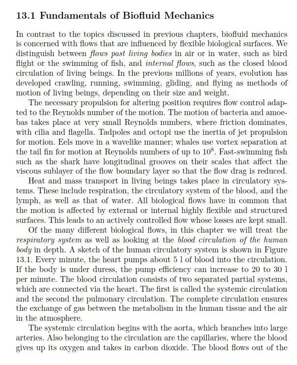

The preview chapter of this book describes how biofluid mechanics can be either about fluid flow around the organism (air flow around a bird or water flow around a fish, etc.) or about fluid flowing inside it (like the blood circulation in veins and arteries).
https://link.springer.com/chapter/10.1007/0-387-21803-3_13
Thank you for the source. It is exactly these two situations - flows past objects and internal flows (in pipe or in circulation) - which I find confusing. It is unclear to me how both of them can be described by the same formula. I may be missing something fundamental.
