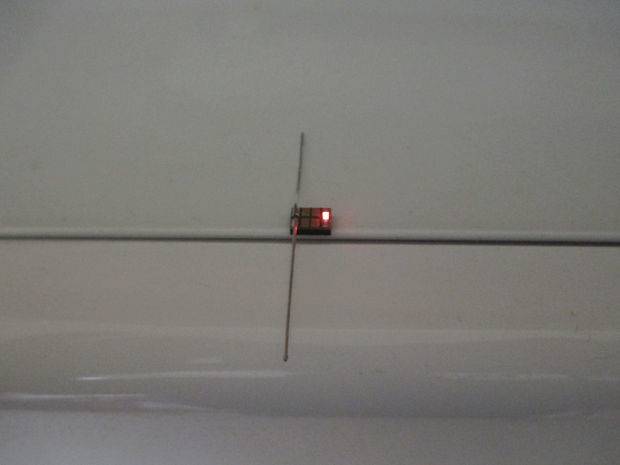

The RFD102A is a broadband RF-DC converter that can be used for your application. The module works from 60Hz...6GHz. I agree with the other posters that there is not a lot of wireless power to be harvested out there and that any wireless energy harvesting system needs to be designed with a wireless source in mind. The strongest source of energy is a microwave oven and to get useful power you need to be within inches of the microwave near the door seam or the vents on the side. WiFi is too weak unless you are next to the router or if you have some custom code to get the router to transmit on all channels. One option to try with your system is to get an RFD102A-DET that is optimized for 2.5GHz and trim the wire dipole in half to get to 5GHz and then do minitrims to center the frequency response at 5.8GHz.
My Microwave oven is probably running for an average of 10 minutes a day. How much total energy, leaked to the outside world does that represent? You really need to get real in discussions like this one (which, to my mind, border on the surreal).
If you can get that close to your microwave oven, then buy a mains splitter and use that other mains outlet for as much energy as you want. It won't be free but it is certainly easy to access and the necessary equipment would be cheap and readily available.
