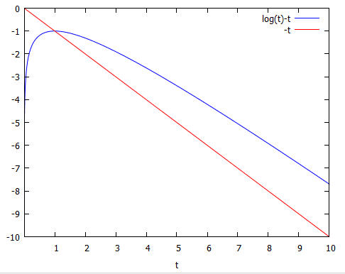

It doesn't look like the asymptote is simply -k t (i.e. a line with intercept = 0), as you can see from the plot (I chose k=1):

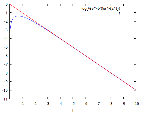

In a related case, A(t) = Ln[exp(-k1 t)-exp(-k2 t)], with k2>k1, the asymptote is -k1 t, and that indeed matches what you see on the plot (k1=1, k2=2):

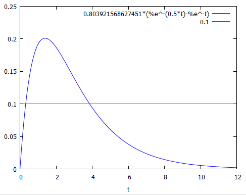

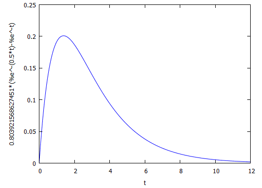

Here's the plot of the function for a typical case (D0=1 mg/kg, F=0.8, k=0.5 h-1, ka=1 h-1, V=2 L/kg). The time t is expressed in hours, and C(t) is expressed in mg/L:
To get the desired pharmacological effect, you often want this concentration to be above a given value (let's call it 'EC' or effective concentration) for a sufficiently long time. There are other metrics of efficacy, but this one ('time over EC') is very common.
So, say that in this case EC is 0.1 mg/L. If you add the EC line to the above graph:
you can see that the time over EC is a bit less than 4 h.

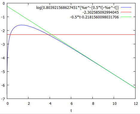

For the right hand side, I couldn't find a nice Taylor approximation, so I considered that Ln(C(t)) has a right asymptote that is reached quite early, and decided to intersect Ln(EC) with this asymptote. Here's the plot:
Obviously there is a small error in using the asymptote rather than the actual curve, but nothing I couldn't live with.

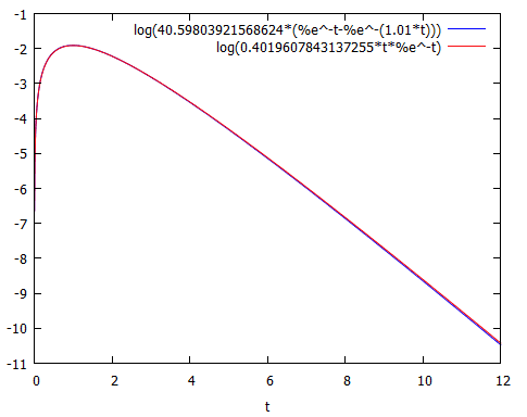

What I find utterly crazy is that if I 'cheat' and use the original C(t) with ka≈k (e.g. 1.01 and 1, respectively), I get a curve that is almost identical to the one obtained with the new equation in k only, even in log scale:
Not unexpected, OK; but then I'm even more gobsmacked that the new equation should not allow asymptotes...
