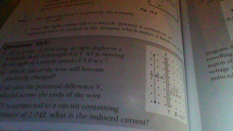

I have a question that involves a wire XY (X moving down the page to Y) moving to the right of the page at right angles to a magnetic field that acts out of the paper. The question then asks me which end of the wire will become positively charged. The textbook uses conventional current, and Fleming's right hand rule for induced currents.
2. The attempt at a solution
I know that current will move from X to Y as given by Fleming's right hand rule, and I know that conventional current is defined as being in the direction of positive charge flow (the opposite of the actual electron flow). By this logic, I assume that X will be positively charged. The textbook, however, states that Y will be positively charged.
Is the textbook wrong, or does Fleming's right hand rule give the direction of actual electron flow, rather than the direction of conventional current.
After some looking around, I can see that Fleming's Right-hand rule uses conventional current, but that doesn't explain to me why the textbook got the answer that it did.

Hi, According to your answer and the right hand rule related to it-The wikipedia page for Lorentz force says "positively charged particle... will curve perpendicularly to both the instantaneous velocity vector v and the B field according to the right-hand rule (in detail, if the thumb of the right hand points along v and the index finger along B, then the middle finger points along F)."- The force on the electron will downwards, thus Y should be negative, as I thought it would be. Could you just confirm this- I'll attach a picture of the diagram:

"in detail, if the thumb of the right hand points along v and the index finger along B, then the middle finger points along F" is valid for a positive charge. In that case, the force points downward, so Y becomes positive.
You may say that the positive ions in the metal can not migrate. Determine the Lorentz force exerted on the electrons: it is opposite, so it acts upward. The electrons accumulate at the top of the rod, X it becomes negative, Y positive.
If you use the cross product ##\vec F = q [ \vec v \times \vec B ]## with q= -e, ##\vec v = (0, V, 0)##, ##\vec B = (B, 0, 0)## ##\vec F = (0,0,eVB)##. An upward force acts on the electrons.

Oh I didn't see that the wikipedia article was referring to a positive charge. Thank you very much, I understand now why the electrons accumulate at Y. I'm going to use the Lorentz Force instead of Fleming's right hand rule for this kind of question. I also see now that the magnetic field has made electrons move from Y to X and thus the conventional current will be the opposite of this, from X to Y. Again, thank you so much, you have really helped me.
