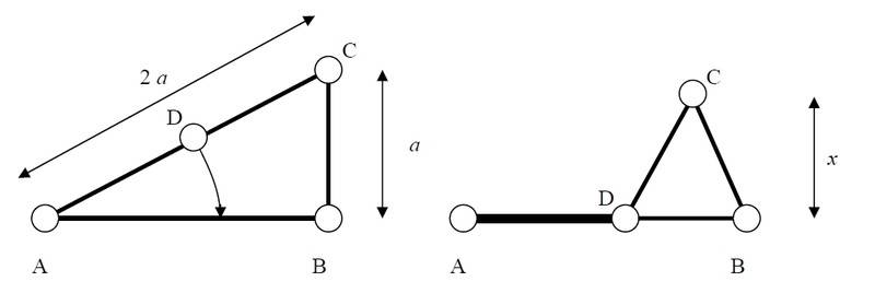

A right triangle ABCD is formed from four jointed links. The joint D at the midpoint of the hypotenuse is pushed until it lies on the leg AB.
Find the height x when a = 50 mm
give me a hint please cause I'm lost :mad:

Well, if I was given a right triangle and the length of two of the sides, I would first find out what the length of the third side is, Pythagoras.
ok, let the distance AB=x
(2a)2=a2+x2
x2= 4a2-a2=3a2
x=[tex]\sqrt{}3[/tex] * a
x=86.60mm
and then DB=86.60-50
DB=36.6mm.
But then?
I would find the angle DCB using the initial right triangle, then note that the new, smaller triangle is isosceles because DC=(2a)/2 and CB=a. Then use the fact that the altitude from C bisects angle DCB and creates two new right-triangles...you then have a relation between angle, height, and hypotenuse.
sounds complicated!
How can we find the angle DCB ?
hello
AB-a=86.6-50=36.6mm
now, a2=x2+(36.6/2)2
x=46.53mm ?
