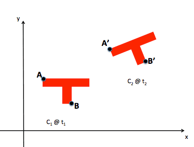

Sorry for being unclear. Let me try to explain what I mean with the picture below:
The T-shaped body is initially in configuration ##C_1## and later passes to configuration ##C_2## through motion. To achieve this, we can translate point ##A## to its new position in configuration ##C_2## and make a rotation about ##A'## of a angle ##\theta## counterclockwise. Or, equivalently, we can translate point ##B'## to its new position in configuration ##C_2## and rotate the figure about it CCW by an angle also equal to ##\theta##. Any other point other than ##A## or ##B## would work too...
But during its motion, the t-shape body must have gone from ##C_1## to ##C_2## through a very specific motion regardless of the fact that there are also infinite different translations+rotations about arbitrary points...
These are different ways to describe the same total transformation C1 -> C2 mathematically. They don't deal with what actually happens in between C1 and C2, they just describe the net difference between the two.
fog37 said:
But during its motion, ...
That's a completely different issue, independent of the description chosen above. The physical object could have gotten from C1 to C2 in an infinite number of ways, which are actually distinct.
It still seems you confuse the mathematical notion of rotation/translation, as an operation that takes points and gives transformed points back, with the physical act of rotating/translating through all the states between C1 and C2.
Thank you A.T. I guess I do confuse the two topics. My topic of interest right now is kinematics and trying to understand the motion of a rigid body that spins and tumbles in the air. Many believe that the object rotates about an imaginary axis passing through the center of mass but that is not the case (it is just a convenient mathematical choice). So I am trying to understand how this hypothetical object is "rotating" (what axis, etc.)

fog37 said:
Is rotation just a relative concept like many others in mechanics? For instance, from the fixed reference frame, can we say that the tumbling object rotate and translate? Rotate about what point?
Any point. For any point you choose, the infinitesimal motion can be described in terms of a translation rate and a rotation rate about the chosen point. But you already know this, so I am having a hard time understanding the question.

fog37 said:
why again is it useful to know that we can geometrically and potentially move the body from one configuration to the next one (finite displacement) using an infinite number of transformations where the rotation occurs about an arbitrary point?
It is useful to know what can be freely chosen:
- to be able to chose what is convenient for you
- to avoid misinterpreting different choices as different situations
