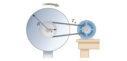

An electric motor turns a flywheel through a drive belt that joins a pulley n the motor and a pulley that is rigidly attached to the flywheel. The flywheel is a solid disk with a mass of 80.0kg and a radius R = 0.625m. It turns on a frictionless axle. Its pulley has much smaller mass and a radius of r = 0.230m. The tension Tu in the upper (taut) segment of the belt is 135N, and the flywheel as a clockwise angular acceleration of 1.67rad/s^2. Find the tension in the lower (slack) segment of the belt.
I don't even know how to start solving this. Our textbook goes over the basic definitions of torque, but I have no idea how to apply this to a circumstance such as this to find Tension.
Well, since I don't even know how to start, I guess I would find the torque as a result of the tension forces? I would appreciate if you could explain how I would start this question, as our textbook is next to useless here.

Yes, you're on the right track with using the concept of torque. How would you find the torque due to the upper tension?
Note that the problem also gives you information about the angular acceleration of the flywheel. So, you need to relate torque and angular acceleration. Your textbook should state the relation.
So, I use the τ = Iα, where apparently according to an answer I saw somewhere else, I = 1/2mr^2, and the angular acceleration is the one given (1.67rad/s^2)?
Yes. The torque on the left side of the equation is the net torque due to all forces.
