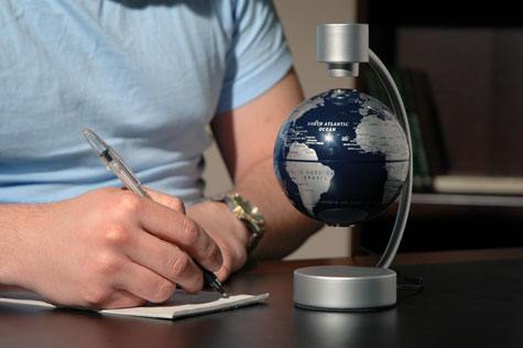

Stable http://en.wikipedia.org/wiki/Magnetic_levitation" . I have one of these, it's really cool.
I have seen a levitation that is not spin stabilized. It is quite delicate, but there in no question it was levitating.
OK, actually suspended. Does that count?
Well, not really. It's an active feedback system. It has batteries and on/off switch in the base. When the power goes out the globe falls down.
Yes. I don't see that as a disqualifier.
Well it's no longer a static arrangement of permanent magnets, which was what the OP was asking about.
It has an electromagnet and a control circuitry in it.
the floating globe uses an AC current to create a rapidly fluctuating magnetic field which is such that the region of lowest energy for a magnet, oriented in some way within the globe, is slightly above where the globe is, to account for the pull of gravity... earnshaw's theorem says that it is not possible to stably levitate static magnets, and having a rapidly fluctuating magnetic field means its not a static at all

OK well, what difference does it make what Earnshaw says if, in the end, we have a levitating object?
His theorem applies to a specific case, namely permanent magnets, and presumably a simple configuration. This, on the other hand, is an engineering problem.
