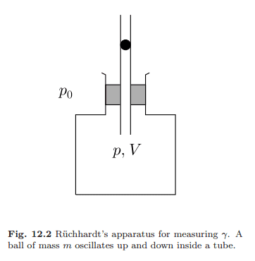

In Ruchhardt’s method of measuring ##\gamma##, illustrated in Fig. 12.2, a ball of mass ##m## is placed snugly inside a tube (cross-sectional area ##A##) connected to a container of gas (volume ##V##). The pressure ##p## of the gas inside the container is slightly greater than atmospheric pressure ##p_0## because of the downward force of the ball, so that
##p = p_0 + \frac{mg}{A}##
Show that if the ball is given a slight downwards displacement, it will undergo simple harmonic motion with period ##T## given by
##T = 2\pi \sqrt{\frac{mV}{\gamma p A^2}}##
[You may neglect friction. As the oscillations are fairly rapid, the changes in ##p## and ##V## which occur can be treated as occurring adiabatically.]

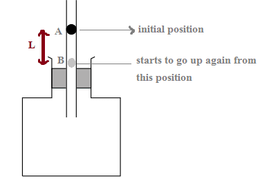

In Rinkel’s 1929 modification of this experiment, the ball is held in position in the neck where the gas pressure ##p## in the container is exactly equal to air pressure, and then let drop, the distance ##L## that it falls before it starts to go up again is measured.
Show that this distance is given by
##mgL = \frac{\gamma pA^2 L^2}{2V}##
##pv^\gamma = const. ##
I have correctly derived the first equation of period of the SHM.
From this equation, I got,
##\omega ^2 = \frac{pA^2\gamma}{mV}##
As the initial velocity is 0, so
## L = 2 \cdot amplitude##
Applying energy conservation for the point A & B, we get:
##mgL = \frac{1}{2} m \omega^2 (\frac{L}{2})^2##
##mgL = \frac{pA^2 \gamma L^2}{8V}##

In the second part, I am afraid your application of energy conservation is not accurate; since in both points A and B you should be getting:
Kinetic energy = 0, Potential energy = ##\frac{1}{2} k A^2## for each of them, which do not give the expression required.
So, my approach would be to break down the different force mechanisms here:
There are 2 forces acting upon the ball: The downward gravitational force ##mg## and the upward excess pressure ##\Delta P## which is given by $$\Delta P = \gamma \frac{P_0}{V_0}\Delta V.$$
Here, ##P_0=p_0=p## is the pressure and ##V_0=V## is the volume at point A in the Rinkel's modification set up of the experiment. (Note that the above formula for excess pressure follows directly from the adiabatic nature of the whole process. Just take the derivative of ##PV^\gamma =## constant.)
