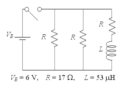

Three identical resistors are connected to a battery, an inductor, and a switch as shown in the figure. (The values of all circuit elements are given below the figure.) The switch has been open for a very long time, and then it is closed at time t = 0.
Part A
Immediately after the switch is closed, the voltage VL across the inductor is
(a) VL = 0 V
(b) VL = 6 V Correct
(c) Neither of the above answers is correct.

KVL, KCL
Part A,
can i just say regardless of any situation, VL is equal to Vbattery immdiately after switch is closed?
Part B,
I can't find the current across L. in this case.
Part C,
I am not sure how to start with this question.
Thx
You need the relation between voltage and current across the inductor.
ehild
A: When you first try to push current through an inductor, does it act like a short circuit, an open circuit, or a resistive circuit?
"current across L" is an odd statement, since current is never "across" anything. Current flows THROUGH things due to voltage ACROSS things. This is NOT semantics, it is integral to how electricity works.
No current? I think...
Yes. Your answer to Part A is correct.
ehild
