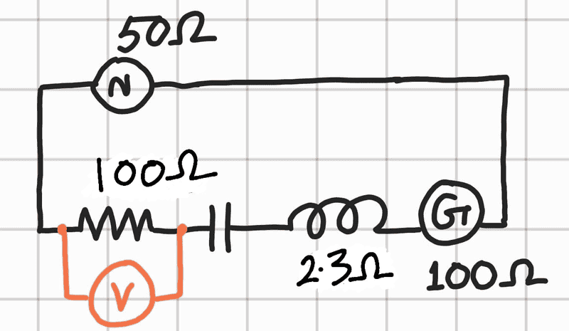

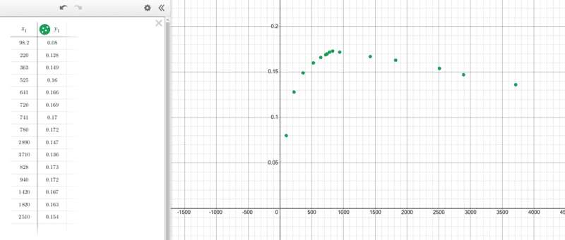

I tried to perform an experiment in my school physics lab with an RLC circuit. I plotted the variation of voltage across resistor against frequency of source.
Frequency of resonance ##\omega^2 = \frac {1} {LC}##
From the graph below of voltage across resistor vs. source frequency, it can be seen that resonance is obtained at 828Hz. But, on calculating the inductance of my inductor (homemade) using ##\frac {1}{(2\pi f)^2C}##, I got 7.9mH. But this is greater than the inductance of the solenoid calculated using ##L=\mu n^2 Al##, where ##\mu## is permeability of vacuum, A is the cross-section of solenoid, l is the length of solenoid and n is the number of turns per unit length . Could someone please help me understand why. Please be kind to help.

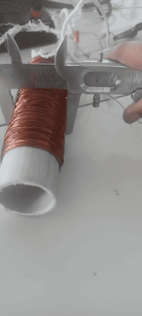

Sorry for that, I have edited my question. Also here is a pic of my homemade inductor.

Those images are a galvanometer (with 100 ohms resistance), my inductor (with 2.3 ohm resistance) and the ac source (which had 50 ohm resistance). I am sorry, i accidentally wrote the wrong resistances, i will edit the image.
Also here is my calculations. Hope this is better. Thank you for your patience
Wait a minute, now that i think about it, the moving coil galvanometer must have had some inductance, right? That must be the reason of my higher value of calculated inductance
The formula for the solenoid works for solenoid, which is supposed to be an ideal model with infinite length and only one layer of wire wrapped around the core. If not infinite, the ratio diameter to length should be much smaller than 1. Your coil does not seem to satisfy any of these conditions. So, why would you expect to follow that formula?

Ok, so calculation result reproduced -- except it's 0.6 mH, not 0.6 mF.
(But where does the 3.84 cm come from ? The picture suggests a lower value !)
Good observation ! It makes one wonder what the galvanometer is doing there ! Its inductance is indeed in series with your coil.
So you are missing 7.3 mH that maybe you can find back in the information about the galvanometer ?
I will check on that. Thanks for pointing it out!
If you are just wanting to understand/verify some calculations for the resonance of a real RLC circuit, I'd leave out the galvanometer since it adds nothing useful to the circuit. If you want to know the current, you already have that in your measurement of the voltage across the resistor.
