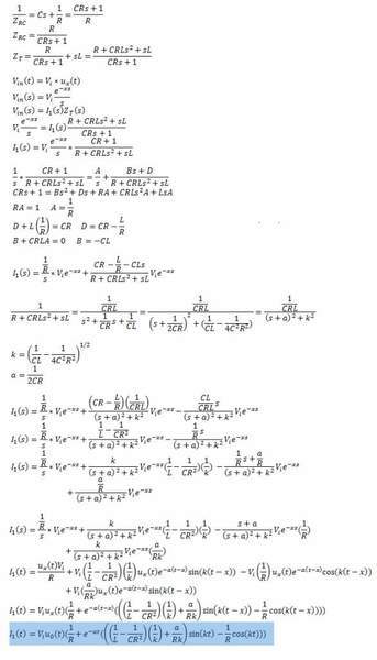

In summary: I have to say that I'm a bit confused. My original derivation is attached as well. If you compare my results to the ones you provided, you'll see that I obtained the exact qualitative behavior of the circuit that you predicted. However, I'm not sure how you arrived at the "a" term in the numerator of the equation. Could you please explain how you came to that result?Thanks for taking the time to reply and clarify.In summary, the link below shows a circuit and the s-domain equation for I1(s) that I have derived. My question is on the portion of the equation containing the "(s+a)" terms. I am trying to arrive at the

The link below shows a circuit and the s-domain equation for I1(s) that I have derived; My question is on the portion of the equation containing the "(s+a)" terms. I am trying to arrive at the time-domain equation for I1(s) but instead of arriving at the Laplace transform pair shown in the link below my math ends up with an extra "a" term in the numerator as shown. I cannot find a Laplace transform pair for the s-domain equation that I end up (as shown in the link below). Have I made an error in the derivation? Has anyone derived this solution? Thanks.

Regardless of your arithmetic, you have made a fatal mistake using Ohm's Law in your solution; it seems that you took the sum of the input voltage in the Laplace domain and the equivalent impedance of the circuit. In my solution, I multiplied both of these Laplacian terms together and came up with a fraction that i decomposed using partial fractions. From there, you can compute the inverse Laplace transform of the two resulting terms to obtain the activity of the circuit. As it turns out, we can cancel some algebraic terms to obtain the exact qualitative relationship that I predicted above.

Hello GuiltySparks and thanks for your response and intuition.
I agree with your comments and was aware of the eventual steady-state currents and voltages that will result after the transient event takes place. This simplified circuit is part of a power systems design where I'm contemplating inserting the inductor Lr so as to slow down the rise of the current when Vi (a DC source switched in via a MOSFET) applies power to the RLC circuit. The idea is to minimize switching loss by delaying the rise of I1. I was trying to derive the time-based equation for I1 so that I could manipulate the ckt values that will control the characteristics of the damped oscillation that will occur as a transient. I am only interested in the transient event.
I worked out the solution and attached it. Notice that I assume at time t = 0 a DC step function is applied.

Thanks for the effort and for the attached derivation; this is very helpful. I will compare it to mine and see where I made and error. Your result makes sense and is what I would've expected.
Doing it was actually pretty informative for me, also. I realized that if you take your source to be Vin/s, then that assumes the voltage on the circuit is always Vin for all time t. You would then need to account for initial conditions when doing the Laplace Transform; incorporating a heaviside function allows us to study just the transient event.
Hello Again, GuiltySparks; I recomputed my original derivation above with your inputs and successfully got the same results as you so thanks again for your input.
