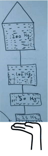

TL;DR Summary: A rocket has has been connected to blocks containing gas of respective masses, there are 3 such blocks, Find Tension between all the blocks 5 seconds after the launch. the main problem comes out doing the problem
There is a rocket shown in the image inserted below, it has been connected to blocks of 200 kg , 100 kg ,50 kg and 25 kg which are connected by massless strings , in those boxes/blocks gas is filled that the rocket uses for upthrust ( assume that the boundaries of boxes are massless), if the initial mass of the rocket is 1000kg and the change of mass per second that is the gas burning per second is 12.5 kg and the velocity of gases with respect to rocket is 5000 meter per second that is the velocity of upthrust of rocket or at which the rocket is travelling. Then we have to find Tension between 50 kg and 100 kg block (T1) AND tension between 100 kg and 200 kg black (T2) after 5 second of travelling of the rocket.
The question can be done but the real problem is coming after doing the question, I found the tension by first finding acceleration after 5 second which can be done by dividing u(dm/dt) by mass at 5 sec {can be found}
after this I made a free body diagram of the 50 kg block which would now weigh only 12.5 kg, after this the T1 = 833.33....... N
similarly T2 comes out to be 7499.99.... or 7450 N
However now if we look from the capability of taking force of objects of specific masses and specific acceleration then things go wrong , as
the capability of 100 kg block at 56.6... acceleration is 5666.6..... and the value of T2 comes out to be 7499.9.... that means T1 should be equal to 7499.9.... minus 5666.6...... = 1833.3...
So why isn't this working, please give a detailed explanation
The tension is zero. First figure out how a rocket works and you will see why. You should also take into account that you cannot push with a string.
See this question is made by me for my students, and the string system is hypothetical I've assumed that the string has tension and have purposely added the rocket to make it a variable mass system.
You may not assume that the string has tension because it cannot with the system you have drawn. If you don't believe me, you can simulate this as follows. Assemble four masses with strings connecting them as shown on the right and put them on a horizontal table to eliminate gravity. Push on one end as shown in the figure on the right to simulate the rocket thrust.
Questions to consider.
1. Does the string "have" tension?
2. How must you exert a force on the end so that the string acquires tension?
3. Is this force in the same direction as the thrust exerted by the gases on the rocket?
Likes Mohammad Ishmas

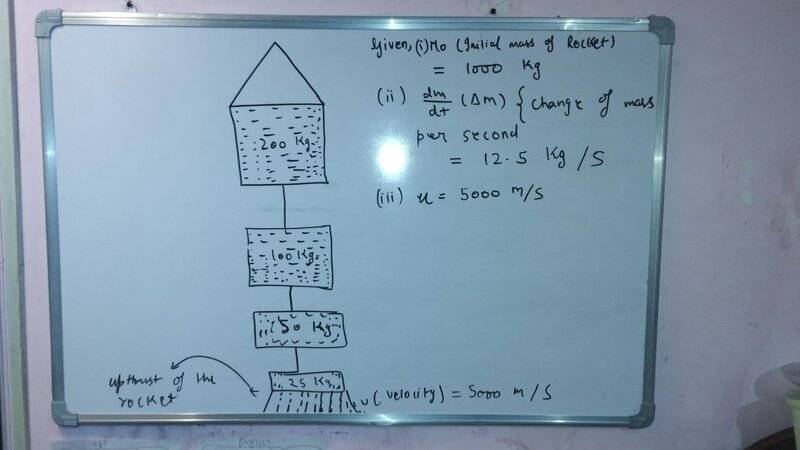

I have to make a question, such that it has a variable mass which adds to its complexity and this will make sure that the question tests the observation skills, the main thing of this question is finding the two tensions, by making Free body diagrams and calculating them. But after this a problem is occurring that is
The tension between the 200kg and 100kg block came out to be 7499.9 ... N which I found by first calculating The tension between the 100kg and 50 kg block {12.5kg after 5 secs} , So the net force in upwards direction of the 100 kg block was 7499. 99.. N - 1000N ( mg) that comes out to be 6499.99 ... N and the capability of force of 100 kg block at 56.66 ... m/s^2 is 100*56.66.66... which is 5666.66... N
Now, the 100 kg block should take should only take 5666.66... N force out of 6499.99.. N force which is correct
as that comes out to be 833.33.... N that is the tension between 50 kg {12.5 kg after 5 seconds} and 100 kg block.
In the same way I tried to find t2 by taking the top of the rocket with the pointy thing and 200 kg block
their total mass was 825 kg as the strings are massless, but after doing the same thing I did to find the tension between the 200 kg and 100 kg block by considering the top of the rocket and then by calculating the force acting on the rocket which I found to be 53125 N, So it has the net force of 53125 N - 8250 N = 44875 N
BUT the capability of taking force of this object is 825*56.66.. {56.66 .. is the acceleration of the rocket at 5 seconds) so that is coming out to be 46749.99.... N . So this is the problem that is coming

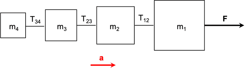

How did it come out to be that value? You do not explain. To get the tensions you need to find the acceleration from the free body diagram (FBD) of the entire system. Note that
All masses have the same acceleration at all times otherwise they will not move as one. See the FBD below.
Let ##F## be the net force on the 4-mass system. We will worry about a number for it later. For the strings to be under tension, this force must act on the leading mass ##m_1.## By Newton's second law, the common acceleration of the masses is $$a=\frac{F}{m_1+m_2+m_3+m_4}.$$ Now we find the tensions.
Note that the net force on the system consisting of only ##m_4## is ##T_{34}##. Then $$T_{34}=m_4 a=\frac{m_4F}{m_1+m_2+m_3+m_4}.$$Note that the net force on system ##(m_4+m_3)## is ##T_{23}##. Then $$T_{23}=(m_4+m_3) a=\frac{(m_4+m_3)F}{m_1+m_2+m_3+m_4}.$$Note that the net force on system ##(m_4+m_3+m_2)## is ##T_{12}##. Then $$T_{12}=(m_4+m_3+m_2) a=\frac{(m_4+m_3+m_2)F}{m_1+m_2+m_3+m_4}.$$ If you want a rocket involved in all this, then ##m_1## must be the combustion chamber providing the thrust, not ##m_4##. All one has to do is find ##m_1## at ##t=5~##s and substitute with ##F=12.5~\text{kg/s}\times 5000~\text{m/s}.##

As I understand it, we have a rocket assembly which totals 1000 kg initially. This includes the masses of four stages. The four stages have initial masses of 200 kg, 100 kg, 50 kg and 25 kg.
In the PDF, you calculate that after 5 seconds have elapsed, the total remaining mass of the assembly will be reduced by ##5 \times 12.5 = 62.5## kg. So the remaining mass is 937.5 kg.
You also calculate that the thrust of the rocket is given by ##v \frac{dm}{dt} = 5000 \times 12.5 = 62500## N.
Applying the calculated force to the calculated remaining mass you get ##a = \frac{f}{m} = \frac{62500}{937.5} = 66.67## m/sec2
You recognize that if this is a vertical launch in Earth gravity that this acceleration will be relative to free fall. So we need to subtract 10 m/sec2 to get the acceleration of the craft relative to the launch pad. Now we are down to ##56.67## m/sec2.
That much is all fine. Though the subtraction of the acceleration of free fall is misguided. Better to adopt a freely falling inertial coordinate system in which the craft is momentarily at rest. The lab frame offers no advantages over this.
You next try to calculate the tension ##T_1## that supports 1 second worth of ejecta against the downward force of gravity.
That is a pointless calculation. There is no string attached to the exhaust plume. Nor is the mass of one seconds worth of plume of any particular interest. Why one second? Why not one hour? One day? One millisecond? Two shakes of a lamb's tail? Our chosen units of measurement should not affect our calculations.
Ahh, I see. The bottom two stages started with a total of 75 kg. The 62.5 kg of ejecta came from them. So the 25 kg bottom stage is gone and all that remains of the 50 kg stage is 12.5 kg. You are calculating the downward force of gravity on that 12.5 kg stage at the 5 second mark.
It is merely an unhelpful coincidence that this is also equal to the mass of 1 second of ejecta.
Since you are working in the lab frame, this is not an unreasonable thing to do. You want a force balance on that 12.5 kg stage. You have 125 N from gravity and an unknown upward force from ##T_1##. The net acceleration is 56.7 m/sec2 upward. So you need a net upward force of ##56.7 \times 12.5 = 708.33## N.
I agree that this requires a tension of 708.33 + 125 = 833.33 N.

Ok I am giving the statement please tell if I can better it
There is a Rocket capsule of 625 kg attached to blocks of 200kg,100kg,50kg and 25 kg respectively by ideal strings. It is launched from earth such that its velocity at which it is going remains constant which is given as 5000 m/s, if the rocket from the bottom most block is losing gas/mass at the rate of 12.5 kg/s then Find tension between the 50 kg and 100kg block and tension between the 100 kg and 200 kg block, take g= 10 m/s^2
This would be the question and I've found the tensions as shown above you can also confirm by doing it yourself. but a problem is coming after finding these tensions

So the velocity remains constant. This means that the acceleration is zero. This flies in the face of the fact that the exhaust velocity and mass flow rate are given and require that the acceleration be both non-zero and non-constant.
Try again.

You are confused about your own problem and about how a rocket works.
After all that I have already said about how the strings can be under tension, give me one good reason why you say that
and then explain to me what part of the rocket provides the required thrust.
OP is confusing the velocity of the rocket with the constant relative velocity of the expelled gas.
