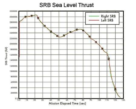

The thrust is not necessarily constant. On the space shuttle, for example, the main engines are throttled twice after launch. I'm not clear on if the SRBs are constant thrust.
As I mentioned above, the change in weight should not be overlooked. For the space shuttle, for example, a halving of the weight is almost as big a factor as the halving of the mass initially. Using the numbers listed above and assuming constant thrust, the acceleration in terms of the fractional increase is:
That's correct. The engines were throttled down to about 64% before max-Q (maximum dynamic pressure), then back up to full, and then once acceleration reached 3g, the engines were continuously throttled down so as to keep acceleration at a constant 3g.
They weren't. They also had reduced thrust at max-Q, about 1/3 less than the thrust right after launch. The SRBs weren't actively throttleable. The variable thrust was instead attained passively by designing the grain geometry so that the surface area of the flame front gradually decreased after launch and then increased again after about 50 seconds into the launch. After about 80 seconds thrust slowly started dropping again as propellant started reaching depletion.
