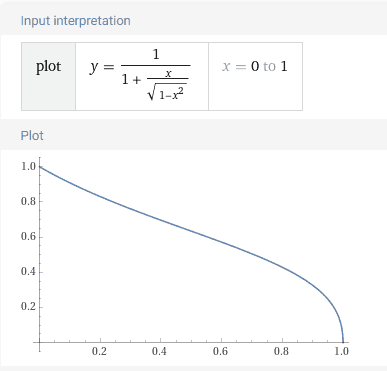

[tex]\frac{m_f}{m_i}=(1+\gamma \beta)^{-1}[/tex]
Please investigate the difference with your result.

[tex]m_i=\frac{\hbar \omega}{c^2}+m_f\gamma[/tex]

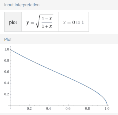

anuttarasammyak said:
Together with momentum conservation
[tex]\frac{m_f}{m_i}=\sqrt{\frac{1-\beta}{1+\beta}}[/tex]
Look good - though the question asks for ##\frac{m_i}{m_f}##, not ##\frac{m_f}{m_i}##. And I'm not sure if, with the rules here, we should give the final answer.
Note that the original question specifically asks for a solution "using four-momenta and three-momenta for the rocket and photon beam". So a solution using 'simple' conservation of momentum and energy equations may not be acceptable - but it provides a useful check if required.

I picked up the simplest case that all the generation of a photon or photon gas takes place in an instant. In usual chemical rocket problem it keeps constant jet during its acceleraion. Is the ratio free from these procedures of acceleration ?
Differentiation equaion of more general case :
[tex]\frac{d(m\gamma)}{d\tau}=-\frac{N\hbar\omega}{c^2}=-\frac{N\hbar\omega_0}{c^2}\sqrt{\frac{1-\beta}{1+\beta}}[/tex]
where
[tex]\frac{dm}{d\tau}=-\frac{N\hbar\omega_0}{c^2}:=-\alpha[/tex]
mass reduced by exhausted photon gas energy per unit proper time. The solution is
[tex]\sqrt{\frac{1-\beta}{1+\beta}}=\frac{m_0-\alpha \tau}{m_0}[/tex]
I found this ratio relation is hold during this jet acceleration process of any constant fuelling pace.
