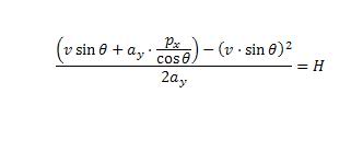

Thanks so much for the help. I attempted to solve it, and I got
it is supposed to be V*cos theta, not just cos theta
I used this equation
And delta y is the displacement of y, which I think is H, so I plugged everything into that equation and solved for H.
Does this look right? I only get one shot a this, and I want to make sure I got it 100% before I turn it in.
Hi physicsguy112! :smile:
Sorry, I have no idea what you've done. :redface:
Yes, vfy2 = viy2 -2gh is correct, but I don't understand the rest at all.

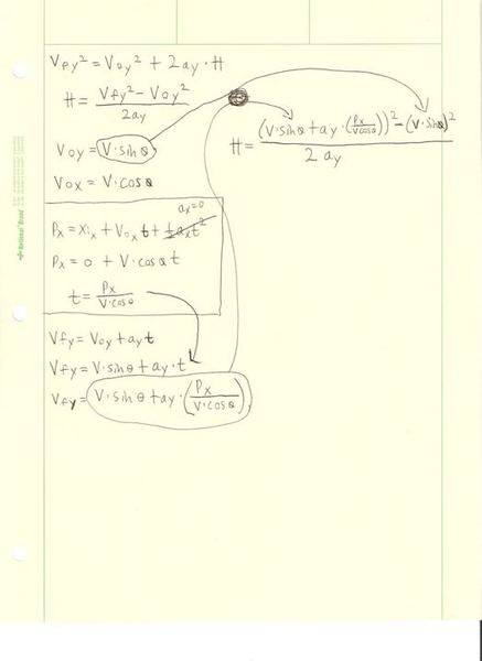

Thanks again for the help, I have uploaded my work and here is the image
The key to my work being correct is the assumption that Voy=V*sinθ and that Vox=V*cosθ.
I am not sure if those are right.
I solved the position function for t.
I solved the final velocity equation, and plugged in the position function solved for t.
Then I plugged that into the velocity squared equation, and solved for H.
I believe my answer must be in terms of θ and V, so I also need to figure out how to get the Px (x position) or t in terms of θ and V.
ok, now I see the working, and that px is the horizontal displacement, your "result" does look correct …
but where does it get you?
You don't know what px is, it's different for different initial angles, and adding an extra unknown (you should be eliminating unknowns) doesn't get you any nearer finding the landing angle.
Hint: decide what the landing angle is, in terms of v H and the initial angle, and then use your original equation (vfy2 = viy2 -2gh) to find it.
