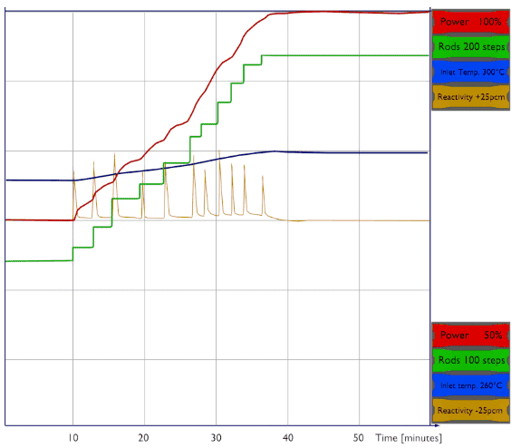

1.) How many steps of Bank D rod motion will be required to change power level from 5% to 18%? Assume that the full power Delta T from primary to secondary is 50 degrees F. Assume the moderator temperature coefficient is -5 pcm/degree F. Assume the Bank D rod worth is 5 pcm/step. Neglect fuel temperature changes.
First, fuel temperature changes cannot be neglected. Reactivity feedback, Δρ/Δ% power, comes primarily from changes in fuel temperature. All you have to know is the total power coefficient, which includes both, the change in moderator temperature and fuel temperature:
Total power coefficient of reactivity is calculated: ∂ρ/∂P = (∂ρ/∂ Tf) (dTf /dP) + (∂ρ/∂ TAVG)(dTAVG /dP)
See: http://www.nrc.gov/docs/ML1214/ML12142A130.pdf
Example from nuclear-power.net:
Let assume that the reactor is critical at 75% of rated power and that the plant operator wants to increase power to 100% of rated power. The reactor operator must first bring the reactor supercritical by insertion of a positive reactivity (e.g. by control rod withdrawal or boron dilution). As the thermal power increases, moderator temperature and fuel temperature increase, causing a negative reactivity effect (from the power coefficient) and the reactor returns to the critical condition. In order to keep the power to be increasing, positive reactivity must be continuously inserted (via control rods or chemical shim). After each reactivity insertion, the reactor power stabilize itself proportionately to the reactivity inserted. The total amount of feedback reactivity that must be offset by control rod withdrawal or boron dilution during the power increase (from ~1% – 100%) is known as the power defect.
Let assume:
  • the power coefficient: Δρ/Δ% = -20pcm/% of rated power
  • differential worth of control rods: Δρ/Δstep = 10pcm/step
  • worth of boric acid: -11pcm/ppm
  • desired trend of power decrease: 1% per minute
75% → ↑ 20 steps or ↓ 18 ppm of boric acid within 10 minutes → 85% → next ↑ 20 steps or ↓ 18 ppm within 10 minutes → 95% → final ↑ 10 steps or ↓ 9 ppm within 5 minutes → 100%
