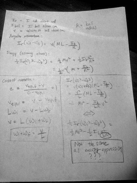

I have decided to upload the image of my written algebraic work. Hopefully it is neat enough for you to read.
On the bottom right, I have used the angular momentum expression, multiplied both sides by ##\omega_i + \omega_f## to utilize the relationship with the coefficient of restitution, and combined. I get a form strikingly similar to the energy expression, but not quite. The denominator of the ball's rot. KE contains ##LR## rather than ##R^2##. Interestingly, the numbers I found before work here.
Where have I gone wrong?

I had forgotten that the ball is supposed to start rolling instantly. This might be why the standard equation does not work. (My original reason for thinking it might not work was connected with the hinge on the rod.)
I'll take the rolling into account and get back to you, but it might be 12 hours or so before I get the chance.
The problem is that for the ball to transition immediately to rolling there must be a horizontal frictional impulse at the ground during the collision. This invalidates your angular momentum equation.
To fix this, suppose the impulse at the collision point is J. In terms of that, you can now write the angular momentum equation for the rod about its hinge and that for the ball about its pivot (the point of contact with the ground). J can then be eliminated between the two equations.
Indeed, we can generalise the problem to two objects with MoIs I1, I2, about their hinge points, some initial angular velocities about those hinges, and respective final angular velocities.
Let the line of action of the collision impulse be r1, r2 respectively from the hinges. (I.e the perpendicular distances to the impulse vector.)
It turns out that the usual linear velocity relationship still arises. If, at the point of impact, the first body's velocity goes from u11r1 to u'1, etc. and KE is conserved then u'2-u'1=u1-u2.

As I posted, it will be easier to take moments for the ball about its point of contact with the ground. That eliminates friction, while producing a second equation with Nt in it.
The time should not matter because N and t always appear as the combination Nt. This is what I was calling J, the impulse between the objects.

erfz said:
So..
For the rod: ##I_{rm}\omega_i - NLt = I_{rm}\omega_f##
For the ball: ##-NRt = -MRv - I_bv/R##?
(I am not 100% sure on the signs of the angular impulse. How does it depend on my conventions?)
Combining these, I get that ##I_{rm} \omega_i = I_{rm} \omega_f + MLv + I_bvL/R^2##. Is there an intuitive explanation here, assuming this is correct?
It looks right. If, when combined with work conservation, it leads to the usual "relative velocity after = -relative velocity before" then that's as close as I can see to an intuitive explanation.
Yes, this expression does allow me to reconstruct work conservation using ##e = 1##.
@haruspex
I'm thinking now, would it be possible to set your axis on the table that the ball sits on and treat the rod and ball as a single system?
This would eliminate frictional torque, I think.
Do you see anything wrong with that?
Like so:
$$m \omega_i L/2 (R + L/2) - I_r \omega_i = m \omega_f L/2 (R + L/2) - I_r \omega_f + MvR + I_b v/R,$$ where I have used the linear velocities of the rod's COM, ##I_r## is the rod's MOI about its COM, ##I_b## is about the ball's COM.
I don't seem to get the same numbers with this expression; something is wrong here mathematically or conceptually.
  • #31
erfz said:
@haruspex
But then you would have torque from the unknown reaction at the rod's hinge.
You can take anywhere as your reference points for angular momentum, but if that means dragging in the reaction force from the hinge or the friction from the table then you will need to bring in a linear momentum equation as well in order to eliminate the unknown. The great benefit of using the rod's axis for its equation and the point of contact of the ball with the table for its equation is that we never get those impulses in the equations.
  • #32
Ah, shoot. I forgot about that completely. Thank you very much!
