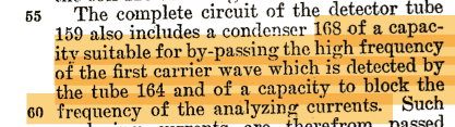

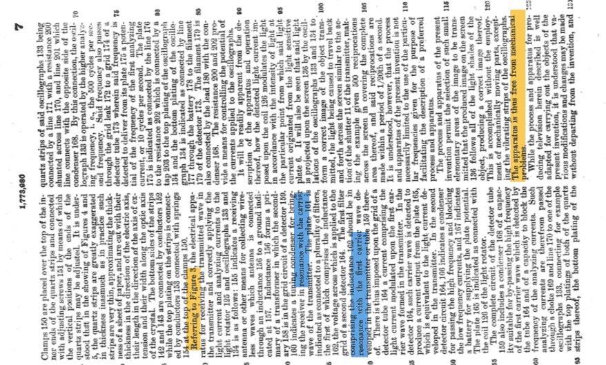

Quoting from the PDF of the patent:
Pg 7, LNs 49-51 "...166 indicates a condenser for passing the high frequency and blocking the low frequency currents..."
Pg 7, LNs 37-51 Indicate that L162 is (self?) resonant with the first carrier, and Pg 4, LN 118 et seq put 'first carrier' at 500kHz

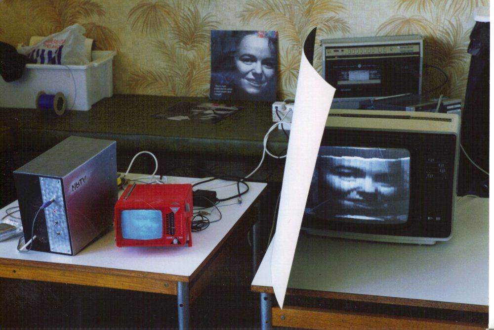

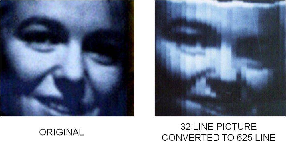

You might like to see a 32 line 12.5 fps image taken with my home made camera about 30 years ago. In the picture, you can see the rectangular camera, which uses a photo multiplier tube and a 9 inch scanning disc. The picture can be displayed on a neon tube/LED and disc or by converting it to 625 lines as I show here. The converter uses RAM in a hardware only circuit. I found that the limitation of these early systems was largely the display device. The actual picture was 312 line 50 fields non interlaced. The sampling was at about 3 times Nyquist, about 54 kbit/s.
Likes Richard Crane, brainbaby, Baluncore and 1 other person
That was a brilliant project and I am really impressed. It sort of goes against my comment, above, but I would suspect that you did not initially learn about TV by building the project. Rather, you used your existing knowledge of TV systems to help you in the 'historic re-enactment'.
Likes brainbaby
I was experienced in TV engineering, but interested to know what the pictures had looked like in earlier times. I did learn about new areas such as optics, low frequency requirements for TV, phase locking a mechanical scanner and digital electronics.
I think the clock was 54kHz and the samples were 8 bit. The clock was the source of every frequency in the system by using dividers ie 54kHz sampling freq, 312 line freq, 50Hz field freq, 400Hz line freq, 12.5 Hz frame freq. The clock was locked to the 400Hz from the camera.
