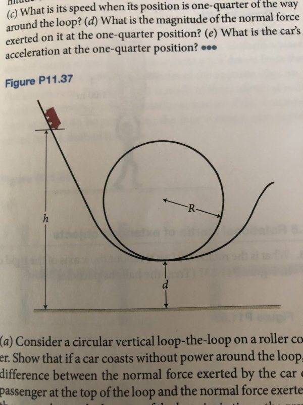

A roller-coaster car initially at position a position on the track a height h above the ground begins a downward run on a long, steeply sloping track and then goes into a circular loop of radius R whose bottom is a distance d above the ground. Ignore friction. What is the magnitude of the normal force exerted on the car at the bottom of the loop?

So, we know that at the bottom of the loop, the car will have a normal force pointing upward and gravity pointing down. However, I have discovered that the normal force is apparently greater than the force due to gravity.
Basically
N = F(g) + ?
What is this other force?
The cart is on a curved track so it is not in equilibrium.
oh wait, then how am I supposed to express the magnitude of the normal force?

Ok I just got mg(1+(2h-2d)/R) for the Normal force.
Apparently, this force -----> mv^2/R is a completely separate force from mg
Here's what I did:
I added mg to mv^2/R, but v is expressed as sqrt(2g(h-d)) from the previous question not shown.

Looks right.

The next question asks: What is the car's acceleration at the one-quarter position?
And I got this : (2g(h-R-d))/(R)
And the back of the book says this is correct, however, I just realized this answer does not include acceleration due to gravity, only the normal force. Isn't the net acceleration at this point in the circle down and to the left?
Something like (2g(h-R-d))/(R * cos(theta)) or g/sin(theta)
If not, what is wrong with these two answers?

I agree that the given answer is incorrect. It ought to include a gravitational component. But to do that, use Pythagoras.
