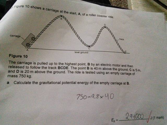

b) Calculate the maximum velocity of the empty carriage at D. (3 marks)
/[/B]
750 x 9.8 = 7350 N
No clue. Can't use SUVAT on the vertical plane to find time because v = u = 0 from peak/trough to peak/trough. Horizontal plane from C to D:
s = ?
u = ?
v = ?
a = 0
t = ?
Maybe I could find u by finding v from B to C? Horizontal plane from B to C:
s = ?
u = 0
v = ?
a = 0
t = ?
Another dead end. Should I be using SUVAT at all?

No, you don't know the shape of the roller coaster.
You calculated the potential energy at point B already. How can you use this?
Likes Rumplestiltskin
Huh, so SUVAT only works on regular trajectories?
Most of it is converted to kinetic energy at point C, and back to GPE at point D.
GPE at point D = 750 x 9.8 x 20 = 147000. Ek would be another 147000 since the GPE is half at what it was at B.
147000 = 0.5 x 750 x v2 (this formula was only vaguely familiar, just touched upon it on the syllabus)
v = 19.8 m/s?

e) The electric motor used to raise the carriage from A to B has a maximum useful power output of 11 kW and completes the lift in 1 minute. Determine the maximum number of people, of average mass 70 kg, that can be allowed in the carriage if the motor is to operate normally.
Really lost, this is kinda going outside of where we're at in the syllabus so far. Help?

11 kW = 11000 J/s. Not sure where we go from here. Energy isn't described in J/s, and it's given that the motor operates for a minute, so I guess I'd do 11000 / 60 = 183 J but I'm not sure what I'm describing. EDIT: Of course I do. Energy used, per second, to operate the motor.
Where P = number of people, 70P kg < ...something.
(70P kg x m2) / s2 < 183 J?
You divide J/s by seconds, so the result has units J/s2, which is not a useful quantity (and it certainly does not have J as unit).
If I give you 5 apples per second, and do that over 60 seconds, how many apples do you get?
Don't forget the cart. No, you cannot just change the units. Think what you did for (a), the potential energy at the top of the hill. You can do the same thing with persons in the cart, and compare it to the energy available (which you still have to calculate in the right way).

300 apples! :D Yeah, that was clumsy. Thanks. So 11000 x 60 = 660000 J.
Right, 750 + 70P kg < something.
So 660000 J is needed to operate the motor in total. Not sure how to proceed. I know GPE = mgh is going to come into this but I'd be fumbling in the dark. The energy available?
EDIT: Okay, conservation of energy. That 660000 goes somewhere, into GPE.
660000 = m x 9.8 x 40.
m = 1684 kg. There's my something.
750 + 70P < 1684
70P < 934
P < 13.3
13 people?
