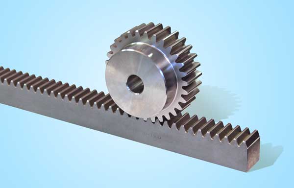

Nidum said:
There was no comment attached to this picture so I'm not sure what message was intended but there would always be some sliding friction as the gear moves along the rack because the paths along the two mating surfaces are different lengths.
