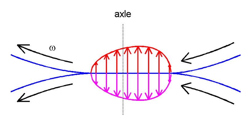

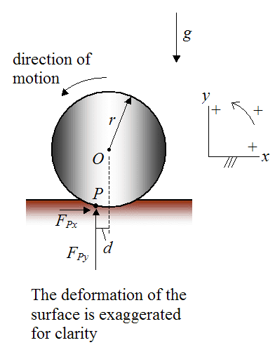

As for rolling resistance, it is actually a moment created by the deformation of the wheel, rather than a force. When rotation is initiated, the normal reaction force is moved towards the front of the wheel and the misalignment between the reaction force and the normal load (which is still at the center of the wheel) creates the moment. As the torque increases, the misalignment increases until it reaches its final value.
When you see a unit of length associated with the rolling resistance coefficient, it corresponds to the length d in the previous figure. The rolling resistance coefficient is then equal to [itex]\frac{d}{r}[/itex] (no units).
This main principle is illustrated in the figure of the rolling cylinders. If two equal cylinders are pressed together then the contact surface is flat. In the absence of surface friction, contact stresses are normal (i.e. perpendicular) to the contact surface. Consider a particle that enters the contact area at the right side, travels through the contact patch and leaves at the left side. Initially its vertical deformation is increasing, which is resisted by the hysteresis effect. Therefore an additional pressure is generated to avoid interpenetration of the two surfaces. Later its vertical deformation is decreasing. This is again resisted by the hysteresis effect. In this case this decreases the pressure that is needed to keep the two bodies separate.
The resulting pressure distribution is asymmetrical and is shifted to the right. The line of action of the (aggregate) vertical force no longer passes through the centers of the cylinders. This means that a moment occurs that tends to retard the rolling motion.
source: https://en.wikipedia.org/wiki/Rolling_resistance#Primary_cause
