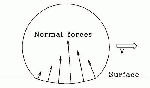

As a very simple model, you can imagine a rigid wheel rolling along a deformable surface that exhibits hysteresis. When the wheel is moving, the material just in front of the wheel is being compressed whilst the material just behind the wheel is relaxing. The magnitude of the work done by normal forces at the front of the wheel during the compression is then slightly greater than the magnitude of the work done by normal forces at the back of the wheel during the relaxation, and the result is that the normal forces at the front are loosely greater in magnitude. You will end up with a resultant normal force with a resistive component.
(Source: https://lockhaven.edu/~dsimanek/scenario/rolling.htm)
But if the wheel is stationary and subject to no other external forces, then the situation is symmetric and there doesn't seem like any reason why the normal forces would be greater on one side than the other, so no rolling resistance. That of course changes if you try to push the wheel out of the divot!

But if the wheel is stationary and subject to no other external forces, then the situation is symmetric and there doesn't seem like any reason why the normal forces would be greater on one side than the other. That of course changes if you try to push the wheel out of the divot!
