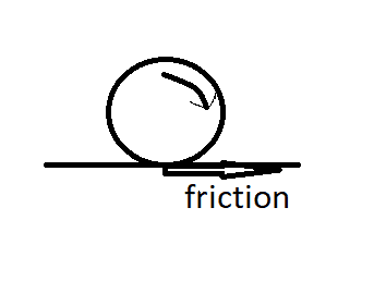

Suppose we leave an object on a non-sloping surface that rolls and moves forward without slipping. Does this object continue to move indefinitely?

but in free-body diagram, the friction force decrease velocity, isn't it?

For rolling at constant velocity the friction force is zero. If the friction force were non-zero, then there would be a torque on the ball.

The friction is zero. The ball would continue to roll uniformly on a frictionless surface. Friction is only required for acceleration and deceleration.

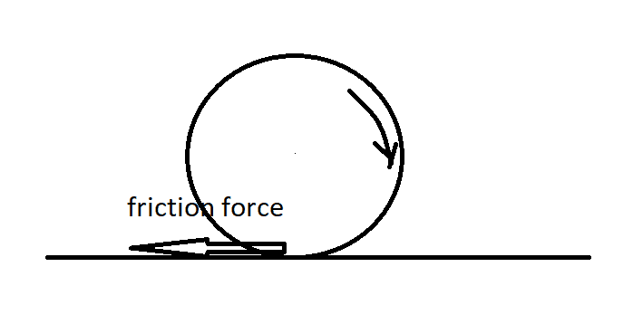

In fact, if you add some air resistance to slow the ball down, then the friction acts in the direction of motion. In the opposite direction to what you have shown.
Note that, in particular, in your model the ball will be slowing down, but its rotation will be speeding up!
This diagram is probably correct because friction reduces rolling, but it contradicts Newton's second law.

That diagram is equally wrong. Look at the Wikipedia page. Rolling resistance is complicated and cannot be reduced to a single force of friction.

because the motion is negative acceleration not possitive acceleration
