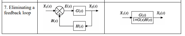

Using the block diagram reduction method for negative feedback:

Okay, I think I have it figured out. All of the examples we covered in our notes were unity feedback based. This lead to a misunderstanding on my behalf.
For root locus, you find the closed loop gain.
You then get manipulate it into the form
$$\frac {f(s)} {factor(1+ \frac {h(s)}{g(s)})}$$
This matches the feedback loop equation and so the open loop gain can be considered to be $$\frac {h(s)}{g(s)}$$
