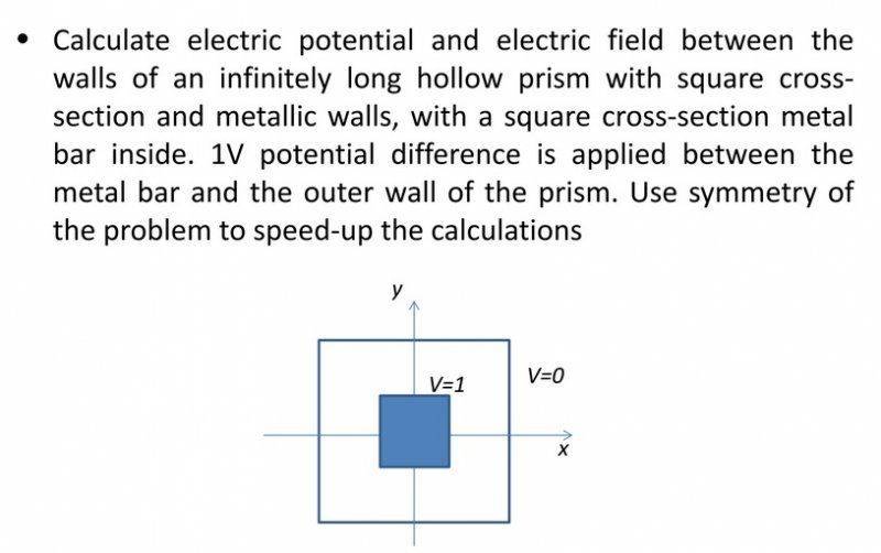

The task is to plot a 2-d surface of the potential and field lines calculated from a numerical method. In this case, there is a charged box (v = 1) @ r = 1 (it's not round, but each side is d = 2 and the center of the box is at the origin) and the edges of the box are v=0. My plan was to use symmetry so that I only have to do the calculations for Quadrant I and then I could do some trickery to set those values for the other quadrants.

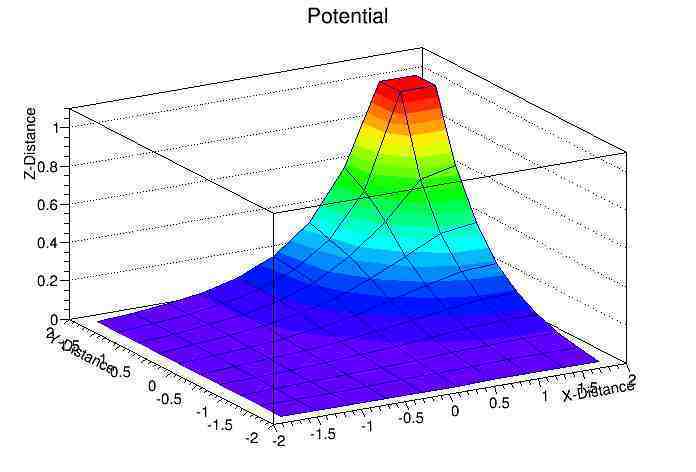

What I'm getting is not what I want. I've attached an image (

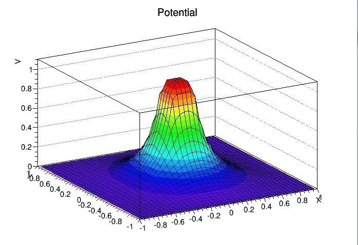

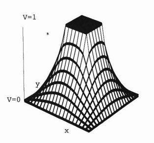

) for reference. What I am looking for is something like (
). I am perfectly willing to use something other than a histogram (TGraph2D, perhaps).

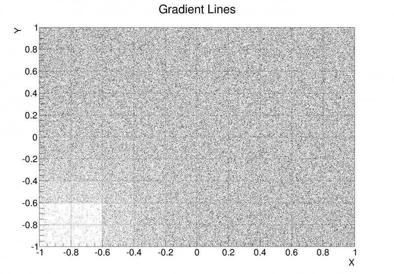

I have some good news to report. My backup plan was to take my data for quadrant 1 and create another array and propagate the data to the other quadrants. That worked. There was still a bug or two that needed worked out and I had to tinker with my bounds to get it exactly right (I initially had the center of the field shifted to the left by .1. I'm now working on the 'draw the field line arrows' section of the assignment.

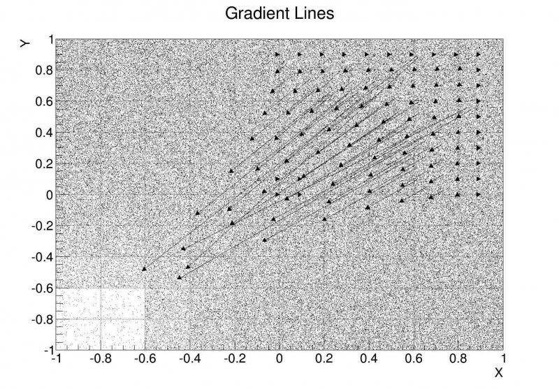

I am getting a lot of schmutz in my histogram, so like the previous problem I've dumped the whole histogram approach and am working on a TGraph. I need a break so I'm headed towards bed and I'll tackle it again fresh in the morning. And yes, I know the arrows aren't even remotely in the right place but at least I am now actually seeing arrows so I'm moderately pleased with that breakthrough.
I've also attached a copy of the 'schmutzy' one just in case someone sees this and says 'OH YEAH! I know how to fix that.' (crosses fingers)
