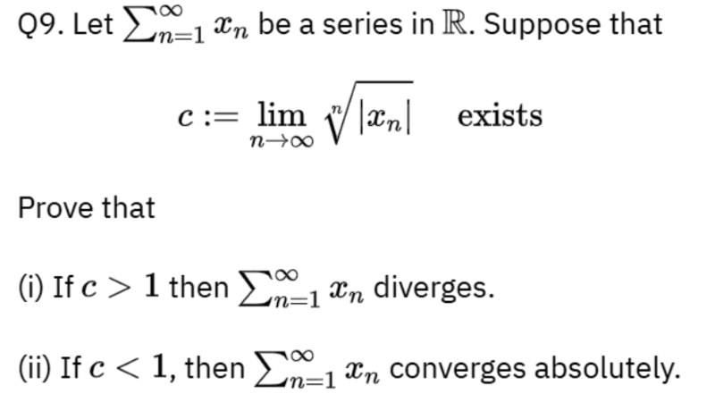

For this problem,
My solution is
If ##c < 1##, then let a be a number such that ##c < a < 1 \implies c < a##. Thus for some natural number such that ##n \geq N##
##|x_n|^{\frac{1}{n}} < a## is the same as ## |x_n| < a^n##
By Law of Algebra, one can take the summation of both sides to get,
##\sum_{n = N}^{\infty} |x_n| < \sum_{n = N}^{\infty} a^n## where ##\sum_{n = N}^{\infty} a^n## is by definition a geometric series with ##0 < a < 1## and therefore is convergent.
Since the geometric series is convergent, then by the comparison test, ##\sum_{n = 1}^{\infty} x_n## is absolutely convergent
Now for we consider ##c = 1## case,
Since ##|x_n|^{\frac{1}{n}} > 1## is the same as ##|x_n| > 1^n = 1##
But, ##|x_n| > 1## for all ##n \geq N## which is means that ##\lim_{n \to \infty} |x_n| \neq 0## or that ##\lim_{n \to \infty} x_n \neq 0##
Therefore, by divergence test, ##\sum_{n = 1}^{\infty} x_n## is divergent
Does someone please know whether this is please correct?
I have a doubt whether we are allowed to use the law of algebra for taking the summation of both sides of the inequality, however, I think we can do that since summation it is just a operation (function that takes input, in this case a formula for the nth term, and produces output, in this case alot of numbers) like addition, subtraction etc.
Thanks!
For finitely many terms, the ordering remains strict, but for series, the ordering is nonstrict in general. Otherwise, yes, comparison with geometric series is sufficient here.

ChiralSuperfields said:
Homework Statement: Please see below
Relevant Equations: Please see below
For this problem,
My solution is
You can, and should, make this much more precise.
Suppose first that [itex]c < 1[/itex], and set [itex]\epsilon = (1 - c)/2 > 0[/itex]. Then by convergence of [itex]|x_n|^{1/n}[/itex] to [itex]c[/itex] there exists [itex]N \in \mathbb{N}[/itex] such that for all [itex]n > N[/itex] we have [tex]|x_n|^{1/n} < c + \epsilon = \frac{c + 1}{2} \equiv a < 1.[/tex] (This explains exactly the rrelationship between [itex]N[/itex] and [itex]a[/itex], and why they both exist.)
It follows that for [itex]n > N[/itex] each term of [itex]\sum_{x=N+1}^\infty |x_n|[/itex] is less than the corresponding term of a convergent geometric series, so [itex]\sum_{n=1}^\infty x_n[/itex] converges absolutely.
(It is true, and at this level trivial, that if [itex]a_k < b_k[/itex] for [itex]k = 1, \dots, K[/itex] then [tex]
\sum_{k=1}^K a_k < \sum_{k=1}^K b_k.[/tex] Summing the geometric series using [tex]
a^{K} - 1 = (a - 1)(a^{K-1} + \dots + a + 1)[/tex] before taking the limit [itex]K \to \infty[/itex] avoids any possible difficulty.)
The case [itex]c = 1[/itex] is inconclusive: consider [itex]\sum_n n^2[/itex] and [itex]\sum_n \frac1{n^2}[/itex].
You have not dealt with the case [itex]c > 1[/itex].

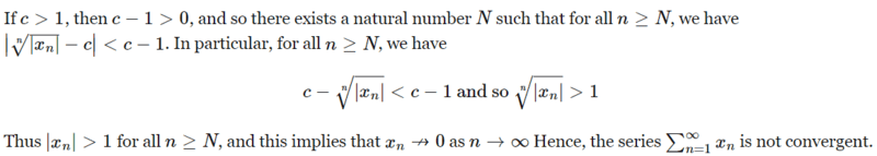

Thank you for your replies @nuuskur , @pasmith and @fresh_42!
I found a similar solution online for the proof for ##c > 1##
However, I'm confused why they did ##\left|\sqrt[n]{\left|x_n\right|}-c\right| = -(\sqrt[n]{\left|x_n\right|}-c)<c-1## where ##\epsilon = c - 1##. Why did they not consider ##\sqrt[n]{\left|x_n\right|}-c<c-1##. I.e does someone please know why they only consider a specific absolute value expansion?
Thanks!
Likes fresh_42
They want a lower bound on [itex]|x_n|[/itex], in order to prove that the series diverges. The upper bound is irrelevant.
