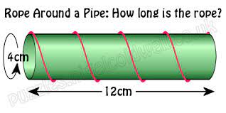

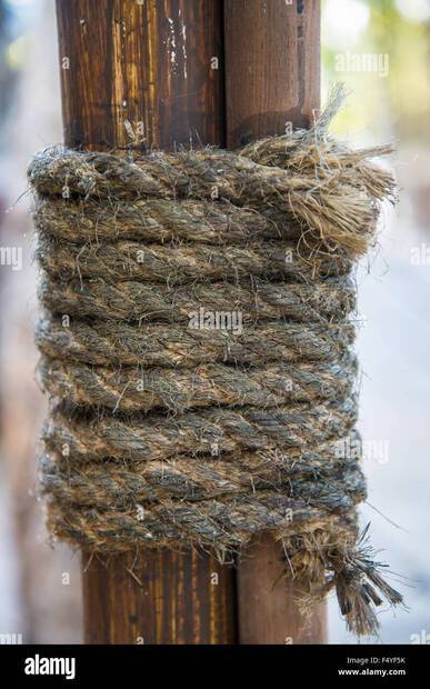

I have a rope wrapped let's say twice around a rod and have two bodies attached to its two ends. I know this equation ##T_2=T_1 \mathrm e^{2\pi N \mu}##, where N is in our case 2. I understand the equation, but I think it is valid only when the rope is wrapped around the rod in a perfect circle, but that is not possible, so my qustion is: is this formula only an approximation?
Ideally, it should look circa like this:
But in reality, it looks often like this:
Is the formula valid also in this case?
Everything is only an approximation.
The rope ends need to be at 90° to the axis of the capstan. In the first picture, there are no ends, in the second you do not show the ends, so it is invalid in both your depicted situations. Other than that, the equation works well.

Of course the rope ends are at 90° to the axis of the rod, I didn't show it in the pictures because I thought it was clear. I showed the pictures to show that the rope isn't often wrapped around the rod in the perfect circle. But as I said, I have two weights at the ends of the rope.
However, my intention was to find out whether the formula is correct both for the first picture and for the second one (when there are two weights at the rope's ends). Isn't there a measurement error for the second picture?
The open helix of the second example would close if the ends were at 90° to the axis of the capstan. It is the number of turns about the axis that is important, not the length of the rope.
