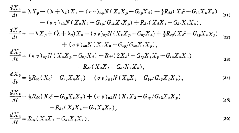

TL;DR Summary
I am using Rosenbrock4 method from Odeint library in C++ to solve a set of differential equations. However, I see that it gives an unusual change in the result for first iteration but afterwards, gives good results. How can I solve it?
The set of equations is
I have first tried to solve only first two equations (removing the components of other 4 equations from them.)
This is the output, where first column is the time, 2nd - X_p, and 3rd - X_n
Likes Theia
How are you setting your initial conditions for this solution?
The ##X_i##'s are elemental abundances during Big Bang Nucleosynthesis. I set the initial conditions equal to their thermal equilibrium values at that point.
I don't know how, but the problem got solved automatically while I was trying to solve another problem. Idk how. Thanks for your reply.
