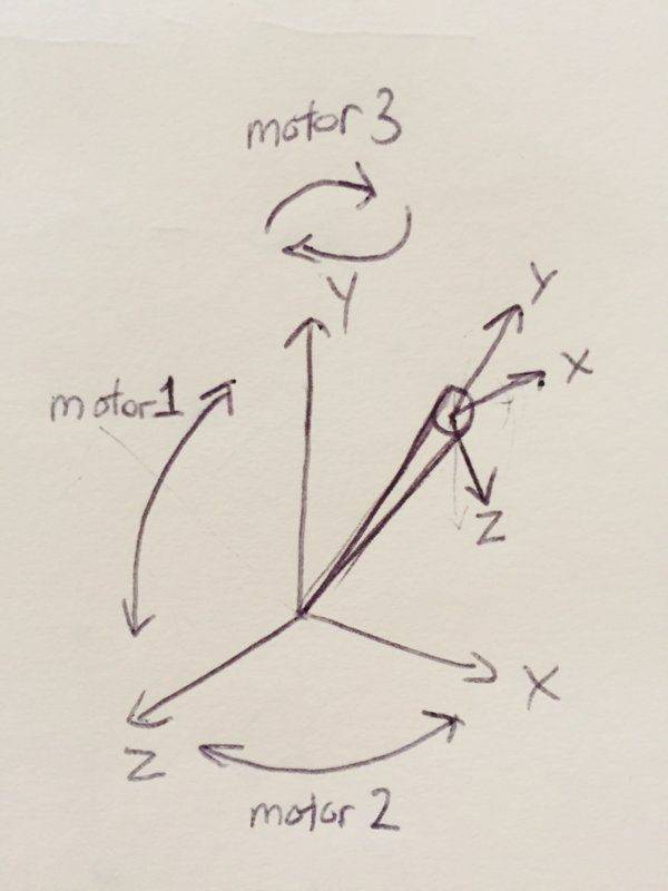

Thank you all for your response.
Basically my problem is that I have a robotic arm and each axes of rotation is controlled by a motor.
I have no idea how to convert Euler angle rotational data to rotational instructions for each motor.
Please see the image.
You may want to research the topic of forward kinematics. All my textbooks (and knowledge) on robotics are age old so I do not have any online reference on the topic. Perhaps others know of a good reference?
Also, if you are to provide command instructions to an actual robotic arm (as opposed to "just" doing the math part), then you obviously also need to research a lot of other topics.
The first thing you need to do is use a standard right-handed coordinate system!

What if I want to simulatenously rotate all axes towards this position? I've been thinking about this for a while, I really can't seem to find a solution. You adjust one axes and it just screws up the other.
Welcome to noncommutivity.
Presumably you have an algorithm to go from some known position to where you want to be? If so you can always exactly reverse it.
Other than the motors do you have feedback about the orientation?
Look up infinitesimal rotations and see if it gives you any ideas. You won't figure this out strictly by fiddling. The Euler prescription always does finite rotations in a given sequence. There is nothing easier for the general case. Maybe your specific requirements are less general but you give no indication. This is not a trivial problem!

Currently the only information I have is two 3d vectors, and their Euler angle rotations.
I did look up infinitesimal rotations
and if I understand correct it attempts to use matrices to solve a transformation?
I did come up with a possible solution in the meantime. Assuming each axis can only have 360 degrees max and there are 3 axes, I could quite simply iterate through all the possible combinations to find the most matching 3d matrix.
(0,0,0) ; (0,0,1) ; (0,0,2) ... (360,360,359) ; (360,360,360);
360 x 360 x 360 = 46,656,000 combinations which a computer could solve and find the closest matching one.

Look this is not that hard.
I'm confused by the drawing. You have two sets of coordinates labelled identically the same. Put primes on the object axes!
How does motor 3 differ from motor 2 ? If motor 3 rotates about y' then this problem is nearly trivial using Euler's angles.

You were right, that was a drawing mistake I put the motor on the wrong axis
The motors are servo motors in this case.
I was able to solve the problem after all. I will explain it below.
Short answer -- you assign each axis a plane (front,side, top), then you align one visible axes at a time with a matching axis on the other vector from these viewpoints.
Long answer --
1.You have two 3D vectors, one for the starting rotation (start vectors)
and the other for the next rotation (next vectors).
2.You take the start vectors and align them with the global vectors so it's now straight on every world axis.
3.You establish 3 world planes, front,side,and top, and assign the appropriate x,y,z axes to each one.
4.You look at the "next vectors" from each global plane, if it's vector(assigned for that plane) is visible with a length greater than 0 you rotate it such that that vector lines up with the same axis vector on the start vector.
5.Repeat for all other planes and keep track of the 3 angles that you rotated the next vectors by.I tested this out and it works really nicely. It did take several hours of coding but it does work.
