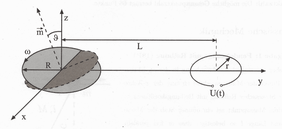

As I`` m learning for an upcoming exam I found an electrodynamics problem I struggle with.
In the first task I need to calculate the magnetic dipole moment of a uniformly charged,thin disk with the Radius R and a total charge Q which rotates with a angular speed omega round its symmetry axis. Which i did in zylinder coordinates:
$$\vec m = \frac{1}{2} \int \vec r \times \vec j(\vec r) d^3 r= \frac{Q}{2 \pi} \int \vec r \times (\vec \omega \times \vec r) d^3 r = \frac{Q \omega R^2}{4} \vec e_z$$
so far so good.
The next task is to take this exact disk and rotate it slowly by the angle theta(t) around the x-axis. There is a conducting ring with the radius r (r<<L) in the xy-plane on the y-axis. It's distance to the disk is L and L>>R. The second task is to approximately calculate the voltage U(t) in the ring.
I thought of calculating the B-field in the z-direction first without an angle. $$\vec B (\vec r) = \frac{\mu_0}{4 \pi} \frac{3 \vec r (\vec m \cdot \vec r ) - \vec m |r|^2}{|r|^5}=\frac{-\mu_0 Q \omega R^2}{16 \pi L^3} \vec e_z$$
The problem begins here as I don't know if I can just add a cos(theta(t)) to the equation to get the right magnetic field that acts on the conductive ring. And then go on with calculating the magnetic flux with $$\Phi = \int_A \vec B \cdot d\vec A$$ and the voltage afterwards with $$U=\frac{d\Phi}{dt}$$ or if I got something wrong by thinking it's that easy. I would be very pleased if someone could help me in that regard.

Hi. Say
[tex]\mathbf{m}=m\mathbf{e_z}[/tex]
[tex]3\mathbf{r}(\mathbf{m}\cdot\mathbf{r})-\mathbf{m}|r|^2=3mz\mathbf{r}-m\mathbf{e_z}|r|^2[/tex]
[tex]=3mzx\mathbf{e_x}+3mzy\mathbf{e_y}-m(x^2+y^2+2z^2)\mathbf{e_z}[/tex]
where position vector r is originated from the disk center.
At the posion of the ring
[tex]x=0,y=L\ cos(-\theta), z=L \ sin(-\theta)[/tex]
and area vector is
[tex] S(0,cos(\pi/2-\theta),sin(\pi/2-\theta))[/tex]
Here I take the disk is at still but the ring rotates for easiness for me.
Do such expressions may help you ?

Assuming the disk and the pick up loop lie on the same plane with parallel axis of symmetry when ##\theta=0##, I suggest you use the law of Biot and Savart to compute the B field at the center of the pick up loop:$$dB(r)=\frac {\mu_0}{4 \pi}\frac {dI(r') \times {(\hat{r}-\hat{r'})}}{|r-r'|^2}$$ where r is the coordinate of the B field and r' is the coordinate of the current element. You can derive or it is shown here http://pleclair.ua.edu/ph126/Homework/HW5_SOLN.pdf that$$dI(r')=\sigma \omega r'dr'$$where ##\sigma## is the charge density. Therefor I get (omitting some algebra)$$B(L)=\frac {\mu_0 \sigma \omega}{4 \pi} \int_0^R \frac {r'dr'}{(L-2r')^2}=\frac {\mu_0 \sigma \omega}{16 \pi}(\frac{2R}{L-2R}+log(\frac{L}{L-2R}) \hat { z}$$
The disk and the loop are co_planar so the field lines threading the loop are perpendicular to the surface area of the loop and we assume that there is an approximately uniform distribution across the area. If we advance theta by ##\frac {\pi}{2}##, the field lines are parallel to the surface area of the loop meaning that the flux through the loop is zero. We write the flux (with A being the surface area) $$ \Phi= A \frac {\mu_0 \sigma \omega}{16 \pi}(\frac{2R}{L-2R}+log(\frac{L}{L-2R})cos(\theta(t))$$and thus$$e(t)=\frac{d \Phi}{dt}=A \frac {\mu_0 \sigma \omega}{16 \pi}(\frac{2R}{L-2R}+log(\frac{L}{L-2R})sin(\dot{\theta})$$

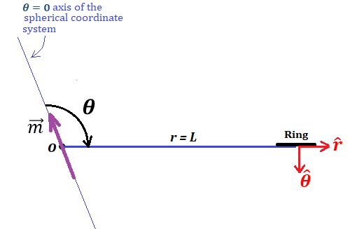

One way to justify that you can "just add a ##\cos \vartheta##" to take into account the tilt of ##\vec m## is to work in a spherical coordinate system.
Wikipedia gives the field of the dipole in spherical coordinates as
Here ##\theta = 0## corresponds to being on the axis of the dipole. So, the coordinate system is oriented as shown below when ##\vec m## is oriented as shown. O is the origin of the coordinate system. The azimuthal angle ##\phi## of the coordinate system is not relevant to this problem and is not shown.
Note that ##\theta## here is not the angle ##\vartheta## given in the figure of the problem statement. But there is a simple relation between the two angles. From this, it is easy to get an expression for the component of ##\vec B## that is perpendicular to the ring as a function of the tilt angle ##\vartheta## of ##\vec m##. This will justify your "just add a ##\cos \vartheta##".
It should then be easy to get an expression for the magnetic flux ##\Phi## through the ring as a function of ##\vartheta## under the assumption that the ring is small enough that the B field can be taken to be uniform over the area of the ring.
