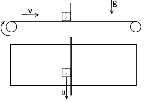

Everybody knows that it much easier to pull out a nail if you pull it and rotate simultaneously than if you only pull it
I guess because it's easier to brake the initial static friction using mechanical advantage (tool grip radius vs. nail radius). But how is that relevant to a bullet?
not only this
directly.The angular momentum expense helps the bullet move inside а bulletproof vest for example. The mechanism is the same: the properties of the Coulomb friction
Likes A.T.
zwierz said:
not only this
As I would word this, the force of kinetic (or static, for that matter) friction has a fixed [maximum] magnitude. If you change the direction of that friction, e.g. by imparting a spin then the component of friction that is aligned with the bullet's trajectory is reduced.
This is similar in principle to doing doughnuts on a car on icy roadways -- if you rev the engine and run the tires at a high rate of speed, the forward traction of the tires does not increase, but their resistance to slow lateral motion becomes almost non-existent.
In pulling a nail, e.g. with a pair of pliers, you will find yourself twisting the nail first one way, then the other, but always pulling. The motion of nail against the wood will be mostly in the twisting direction because that's the direction where the most force is being exerted. But that little bit of pulling tension means that the net motion has a shallow spiral component -- easing a tiny bit out of the hole. Worry the nail back and forth long enough and it'll eventually come free.
If the force of friction were directly proportional to velocity rather than roughly constant then no advantage could be obtained in this fashion. The force of friction in anyone direction would be independent of motion in any other direction.
If the force of friction were more than directly proportional to velocity (e.g. quadratic rather than linear) then a disadvantage could apply. A spinning bullet could experience more resistance to motion than a non-spinning bullet.
Likes A.T.
Note that nobody in this thread has said that the spin of the bullet doesn't affect the penetration depth. It seems reasonable to assume that it might, although I'd like to see some measurements. However, any impact of the spin on the penetration depth is not caused by adding the angular momentum of the bullet to its linear momentum, as was the original question.

The effect with rotating bullet can be illustrated by the following analogy.
Let a horizontal conveyor belt moves with velocity ##v##. There is a fixed rail above the conveyor belt. A matchbox of mass ##m## lies on the belt and rests at the rail. The friction coefficient between the belt and the matchbox is ##\gamma##. The rail is smooth. Then somebody pushed the matchbox along the rail with initial velocity ##u##. Which distance does the matchbox pass till it stops?
This distance is bigger than ##u^2/(2\gamma g)##
this is the reason why I speak about the motion of the bullet through bulletproof vest; in this case it is reasonable to assume friction to be obeyed the Coulomb law
