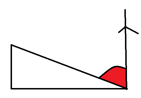

Cylinder length 1.2m, mass =0.1kg, radius 0.5cm is released from rest and roll down without slipping down 2 rails connected to the battery of 10V. Rails at angle of 40 degrees. B = 0.01T. The total resistance of rails and cylinder is 250 ohms. Calculate V after it has rolled down 0.45m
Firstly, I need to determine what the electric field is causing.
Using left hand rule, the force due to the field is acting down the slope.

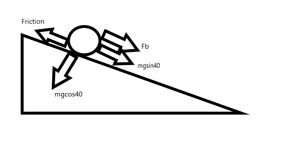

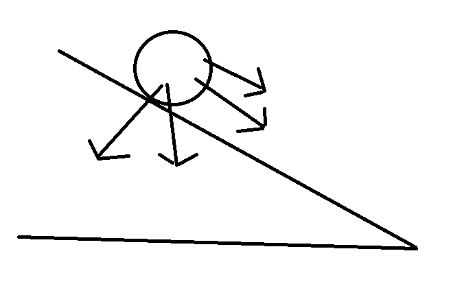

Hence my FBD looks like:
Where the two arrows pointing towards the right represent the force due to the field and weight of the cylinder.

Please draw a better FBD and label all the forces. Do not include both the components of a force and the resultant.
Do you mean by this?

In this case is the EMF:
##\epsilon = BLVsin\theta##
whereby ##\theta## = 90-40 =50 degrees?
Yes, something like this. The direction of Fb is incorrect. What do you need to do to find the correct direction?
In a steady, uniform field, the magnitude of the induced emf is given by ##\epsilon=\dfrac{d}{dt}(\vec B\cdot\hat n~A)##, where ##\hat n## is the normal to the rectangular loop the area ##A## of the loop that is shrinking. Figure it out from there.
jisbon said:
That will be friction, as stated in my updated FBD.
Yes, there is friction, but what kind, static or kinetic? If kinetic, it is opposite to the velocity; if static, it is in whatever direction is appropriate to provide the observed acceleration.

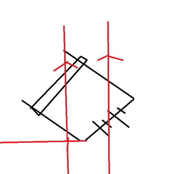

kuruman said:
The fact that the cylinder lies on an incline is irrelevant.
Isn't the red angle supposed to be angle between the field and the velocity (hence 90-40)?
Yes, the red angle is 90-40 degrees, but that's not the issue. The B-field is straight up in the figure.You are looking for the angle between the B-field and the direction of the current through the cylinder. What is the direction of the current in the figure? Hint: It is not along the incline.
