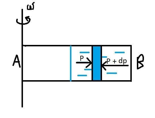

A horizontally oriented tube is rotating with angular velocity ω about one end of the tube which is open. The tube has ideal liquid filled inside it as shown in the attachment. Why does there have to be a pressure difference between two points in the ideal liquid at the same horizontal level?
Doesn't pressure only change with depth and remains constant for all points on the same horiozontal level for a stationary liquid?
Does the pressure difference exist so as to create an unbalanced force which accounts for the centripetal force on the liquid? But centripetal force exists only when a particle is executing circular motion. And when the liquid would have just been poured in the tube, it would slided back towards the closed end of the tube due to centrifugal force. And in the process of doing so (sliding back), there wasn't any centripetal force. So why then all of a sudden does the liquid halt at the end of the tube and starts executing circular motion all of a sudden when it was not doing so anywhere before halting? Why doesn't the liquid keep moving backward because of the centrifugal force and burst open the closed end of the tube?

The fluid is not stationary. It is accelerating.
Yes. Exactly.

Good questions. If you examine the kinematics of the motion, you find that the radial component of acceleration for each fluid particle in the tube is given by:
$$a_r=\frac{d^2r}{dt^2}-\omega ^2 r$$
(see if you can derive this)
The ##\omega ^2 r## term represents the centripetal portion of the acceleration and the ##\frac{d^2r}{dt^2}## represents the contribution of the radial sliding. Before the fluid reaches the end wall, there are no external forces acting on it in the radial direction, such that the radial acceleration is zero, and the sliding motion is described by
$$\frac{d^2r}{dt^2}=\omega ^2 r$$
The external forces that are absent if the above relationship is satisfied are pressure gradients across the fluid. These cannot develop until the fluid encounters the end wall such that
$$\frac{d^2r}{dt^2}=0$$

Sorry. But I don't agree with this. [itex]a_r[/itex] is 0 only when the liquid has reached the end. Anytime before reaching the end, it is not 0. And so its not [itex]a_r[/itex] that becomes 0 but infact [itex]\omega ^2 r[/itex] that becomes 0 making [itex]a_r=\frac{d^2r}{dt^2}[/itex]. Rest of the explanation is pretty fine with me. :)
You seem to be thinking that ar is equal to d2r/dt2, but it's not. It is the sum of the two terms, one being the centripetal acceleration.
[itex]\omega ^2 r[/itex] is never zero in this system. The tube is forcing the fluid to rotate, irrespective whether the fluid it is also moving radially.
