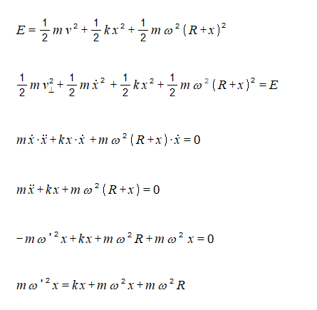

As for the energy of the system, the spring and the mass form an isolated system. Its energy should be, I think—$$E =\frac{1 }{2 }m {v }^{2 }+\frac{1 }{2 }k {x }^{2 }+\frac{1 }{2 }m {\omega }^{2 }{{\left( R +x \right) }}^{2 } $$
Here ##v ## is the magnitude of the net velocity of the mass, and the last term is the potential energy due to the centrifugal force. After differentiating and setting it equal to zero, I got ##m \omega {' }^{2 }x =k x +m {\omega }^{2 }x +m {\omega }^{2 }R ##. But this doesn't look like a simple harmonic oscillator to me, because of the ##m {\omega }^{2 }R ## term. I have attached the full calculation I did.
I think I'm failing to understand the uniform circular motion aspect of the problem. It's the first time I'm encountering a "partial" circular motion where only one of the components of the velocity is really going round in a circle.

kekpillangok said:
So the resultant force should be $$ F _{net }=m {\omega }^{2 }{\left( R +x \right) }+k x =m {\omega '}^{2 }x $$
Back off for a moment and just consider F=ma:
$$ F _{net }=m {\omega }^{2 }{\left( R +x \right) }+k x =m \ddot x $$
First, I think you have a sign error in there.
Secondly, you have a nonzero acceleration when x=0. So x is not the perturbation from equilibrium. Adjust the independent variable accordingly.
Likes Vanadium 50
Does it? Is it?
What keeps it at constant ω? I don't want to belabor the point - I want you to think about what approached will not work.

Yeah, my bad, I didn't consider it very carefully—it's an external force keeping it at a constant angular speed, so that I wouldn't be able to apply conservation of energy in the form I used there.

Vanadium 50 said:
Does it? Is it?
We are thinking, for instance, that the oscillator is confined to a well-lubricated slot in a disk that is rotating at a rate of ##\omega##? The disk then being coupled to a drive axle at the center of rotation which supplies whatever torque is needed to preserve the fixed rotation rate?
If one adopts the co-rotating frame then the torque from the drive axle does zero work.
One does have a centrifugal potential to deal with.
