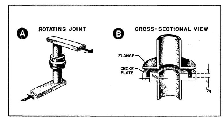

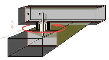

there's nothing as such "in there" as they are a hollow waveguide
there are just some variations depending on the designer/manufacturer
Likes artis and sophiecentaur

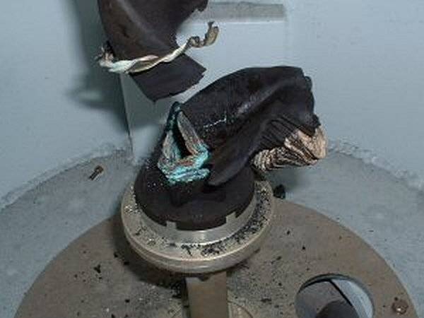

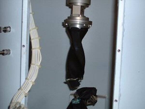

Have had these 2 pic's stashed away on the PC for many years
But sometimes things go wrong with rotary WG joints
The rotary joint ceased and the flexible section of WG kept turning till it tore in half
I imagine that maintenance visits up the mast or onto the roof are no fun. There's a lot of salt and weather up there to do damage.
