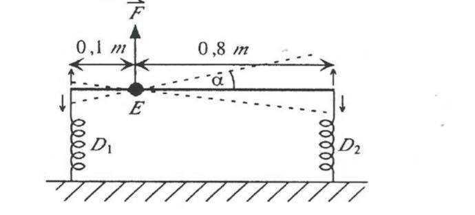

A stick is on two springs with spring constants D1=500N/m and D2=300N/m. Consider the stick is without mass and can rotate around the point E, which is distant from spring 1 with 0,1m and from spring 2 with 0,8m. A force F=100N pulls the stick up. (sketch below)
a) Calculate the distance by which each spring will be stretched.
Here i got x1= 0,177m and x2= 0,037m

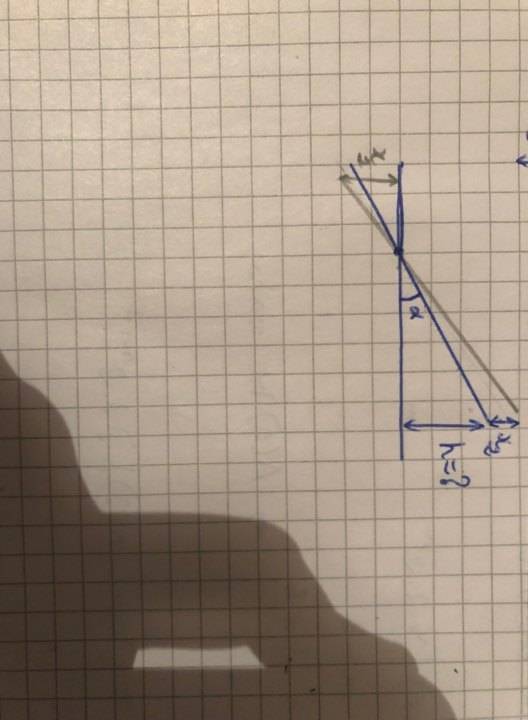

b) calculate the inclination angle (see sketch)
Do you have any idea how i can calculate the angle? A detailed answer would be very much appreciated.

Start by drawing a free body diagram (FBD) of the stick, and then use the fact that the system is stationary (stick is not moving). What can you say about the sums of the forces and moments in such a situation?
It is what I used for calculating the stretch-distances. However, for the angle, i should figure out some height combined with some horizontal distance and use the sine or tangent function on some triangle. This is where i am confused, what height and horizontal distance to consider and why?

What about taking moments about a suitable point?

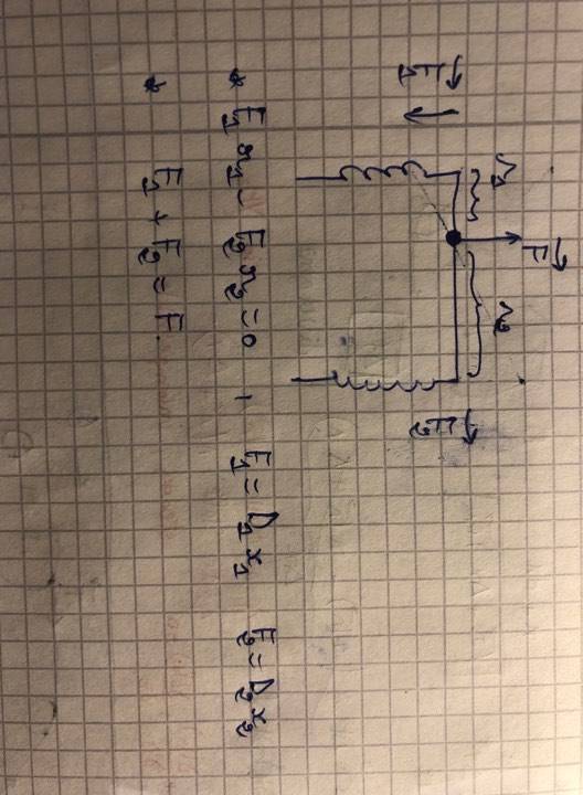

Can you please show us your FBD and sum of forces and moments equations? You should take into account that the springs are no longer vertical in the final position...

F1 and F2 being the amplitudes of each force
It might help you to draw a second, simpler, diagram, just showing the rod at an angle and the displacements you found for its ends.

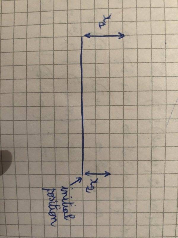

does this make sense? if it does, i can't conclude what the height h is. I am tempted to say its the difference of the two extensions, but i can't really see why.
No, the diagram is wrong. (Is that "x3"? What is that?)
You found two extensions, both positive. Draw the initial position horizontal, the two extensions and the final position. But note that the extensions will be heights vertically above the initial position of the rod, not distances from the endpoints in its initial position.

How to draw the final position? Joining which points?

One end has moved up x1, the other up x2, so which two points do you think?
And as I implied, you should not take the "original position" as representing the whole bar. It only represents the height the bar was at. You need to set the distance between the two displacements in the diagram to match up with the final position.
